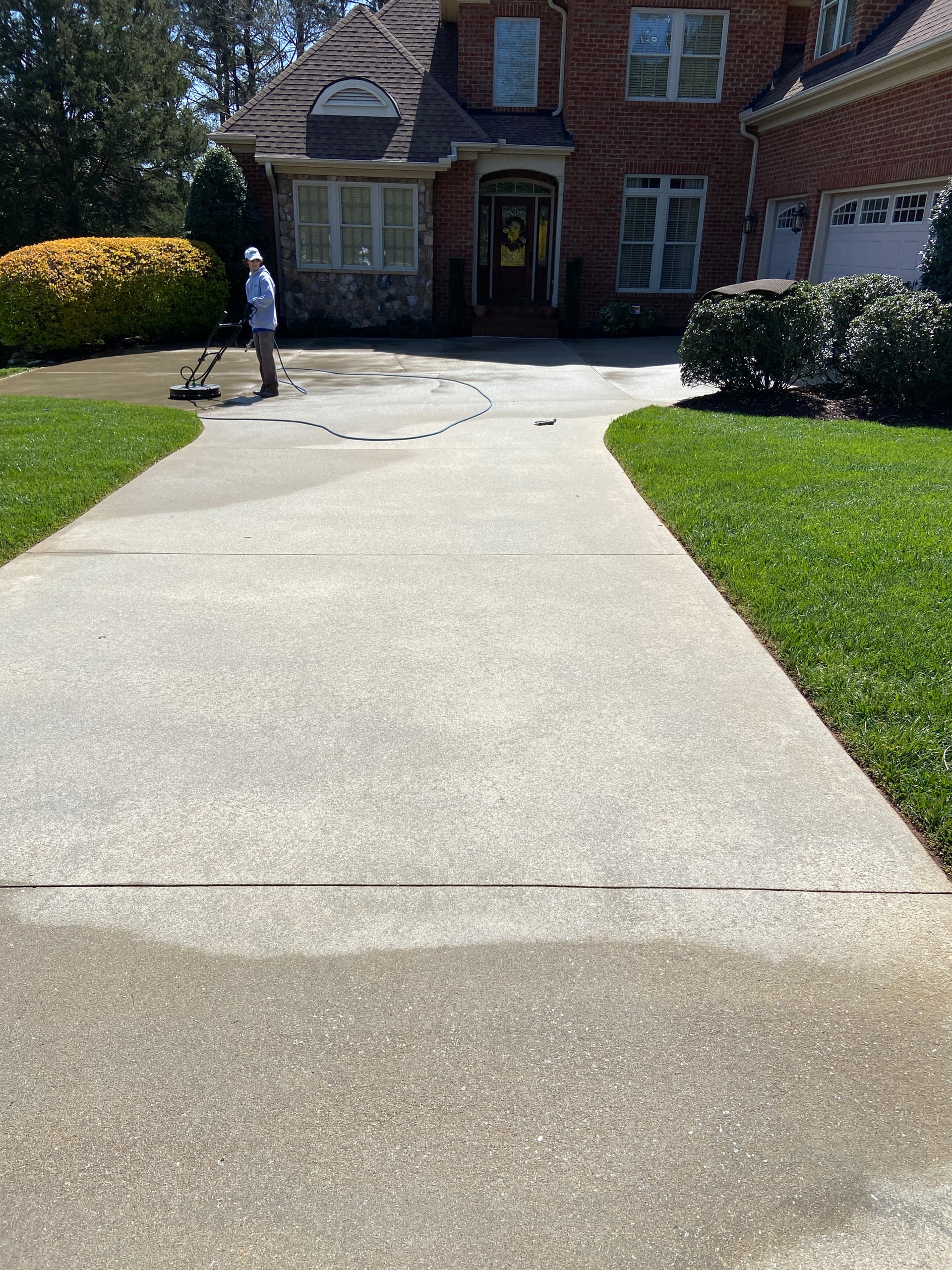

Here is a pretty dirty drive that I did this week. This is the photo after cleaning, but before any post treat. As you can see it doesn’t need much.
Looks great. I run a 4 gpm machine with a 18 or 20 inch SC so my pre and post is always 3%. Im not set up where I can change percentages for pre and post. For driveways that are not totally caked bad are you suggesting i reduce my mix? Not trying to be a smart â– â– â– , you know I will follow whatever advice you give over anybodys.
