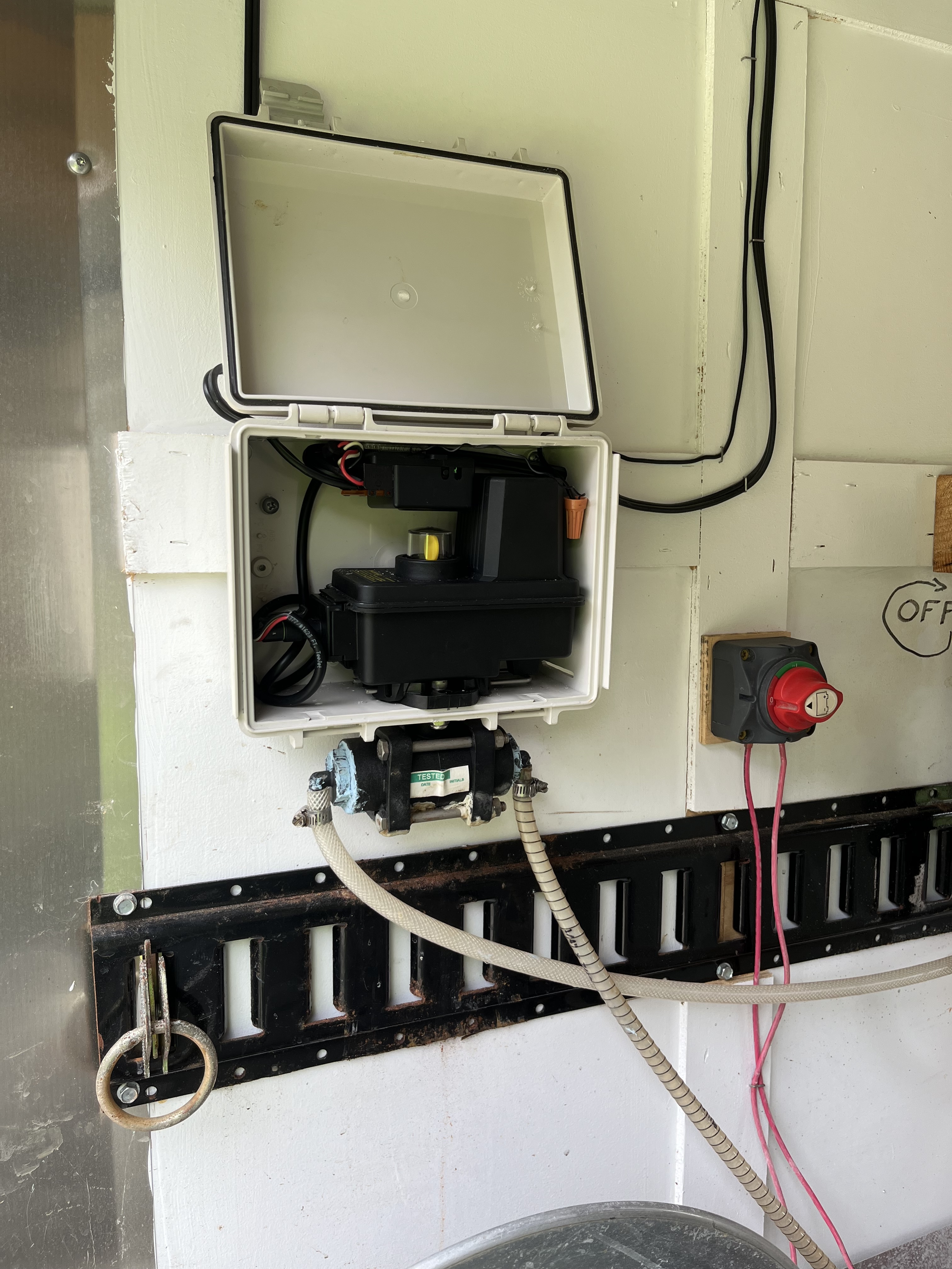

I just made my own remote box, Teejet valve and remote.
Chris, can you show us that remote valve setup? How much did it cost to make? How reliable is it?
I’ll get a pic later, I think at the time the Teejet 2 way valve ran about $230, but they’ve gone up quite a bit. I was using those cheap blue on/off valves but they kept quitting after a couple months.
The remote is just the simple 600’ on/off one, but I did wire a flashing strobe to the top of the trailer so I can tell if it’s on from the other side of a house.
It’s been super reliable, the valve is going on three years without much issue. I was getting some air suction leaks but the Blue Monster pipe sealer helps.
As promised, pic of the DS remote I put together
