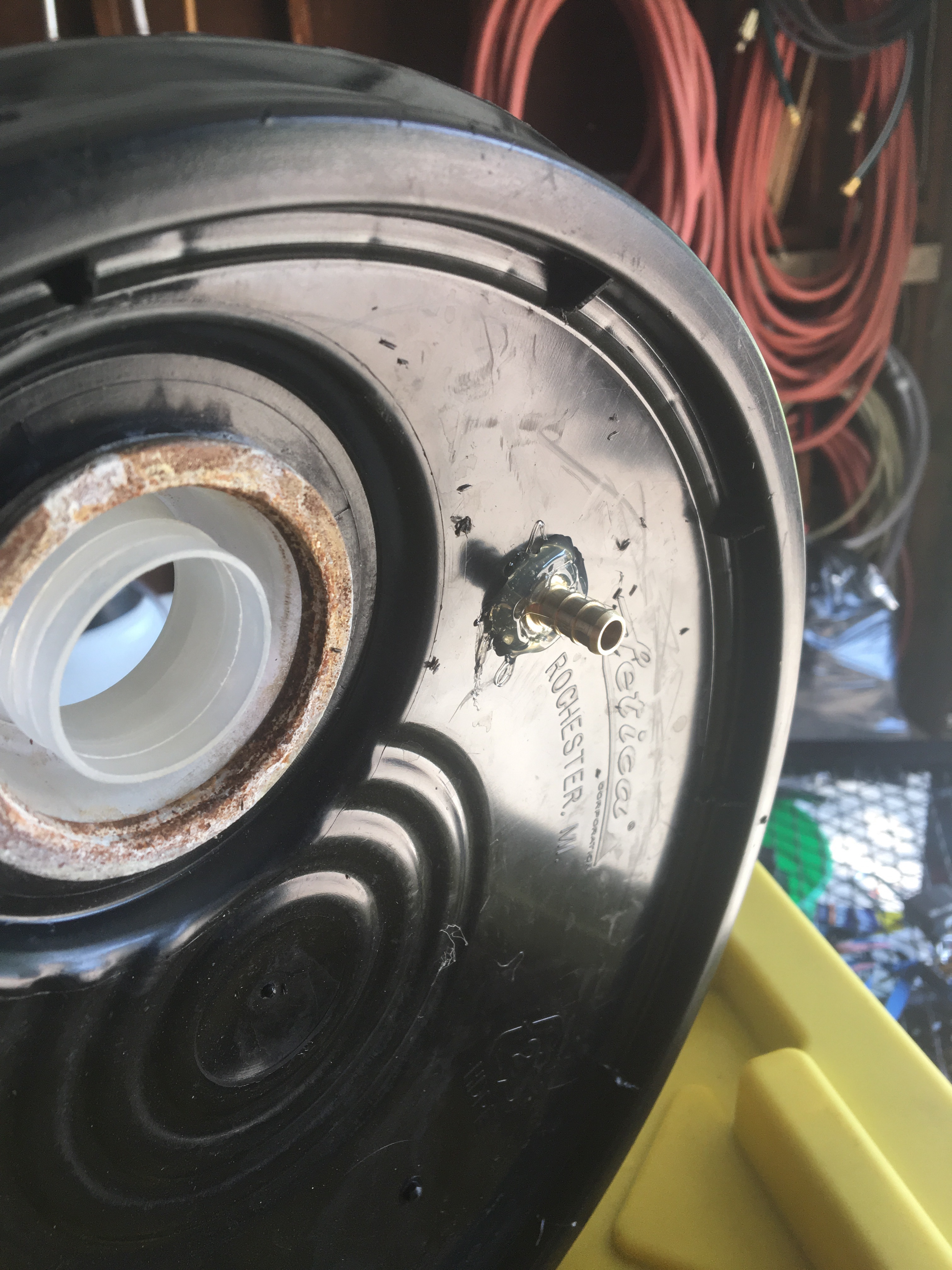

I will. I use 6 & 7 gallon black buckets for storage of SH and a dedicated chem tank on the trailer for downstreaming. Modified one of the lids of the black buckets to draw from after seeing one of innocents videos.
I used to use a big spring clamp to hold the hose in the bucket and it wasn’t very effective. Modifying one of your buckets will make your x-jetting life a lot easier. Edit: just taper the bottom of your draw tube. I tried to get too close to the bottom on the first iteration and the tube literally sucked to the bottom of the bucket.
