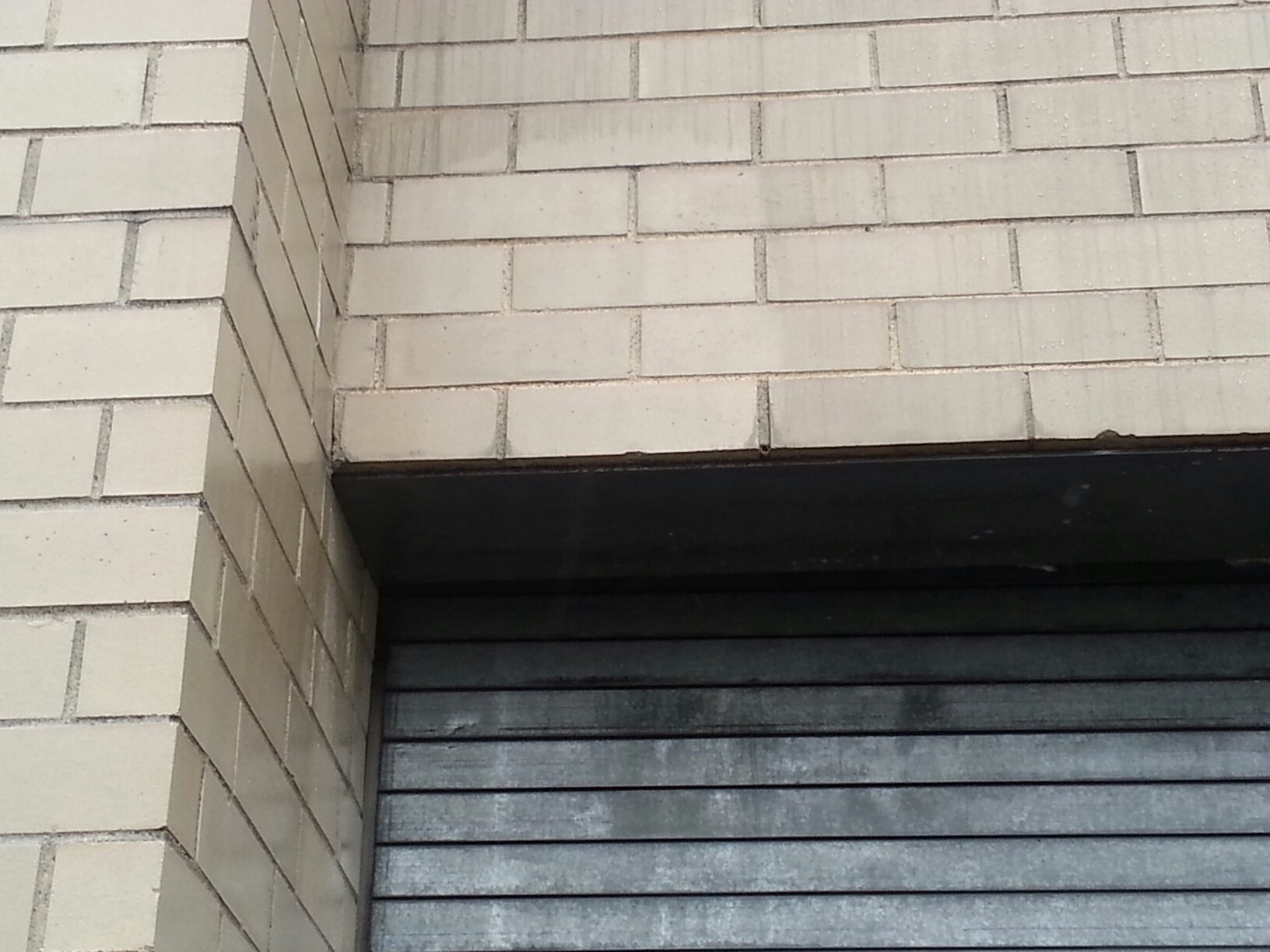

Here’s the sample of One Restore that sold the job. This bldg is covered in these black lines and blasting them to Kingdom come and they wont come out. This dealership has some 1/2 million dollar plus high end cars in here and they want a bldg to match what they sell.
Commercial samples go along way:)
