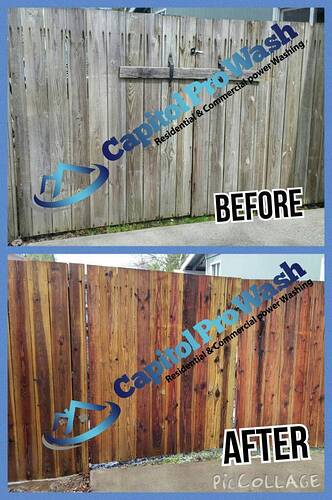

I would soak it down good with water first. Let the wood get hydrated then hit it with the ds of hw mix. Let dwell for 5 min and rinse. Repeat as necessary. Ds some ox and get paid.

That’s what I get using the method I explained. All from my jrod tip with ds nozzles.

Don, great before and after pictures, good job. And you pre-wet the wood first, to keep your cleaners
where you want them.On the surface of the wood, not soaking in to the wood. Everett Abrams has a
great video on You Tube, Proper Exterior Wood Cleaning & " The Soft Washing Scam". Good work!:rolleyes:

Thanks Bill, thats where I learned it from…the wizzard
