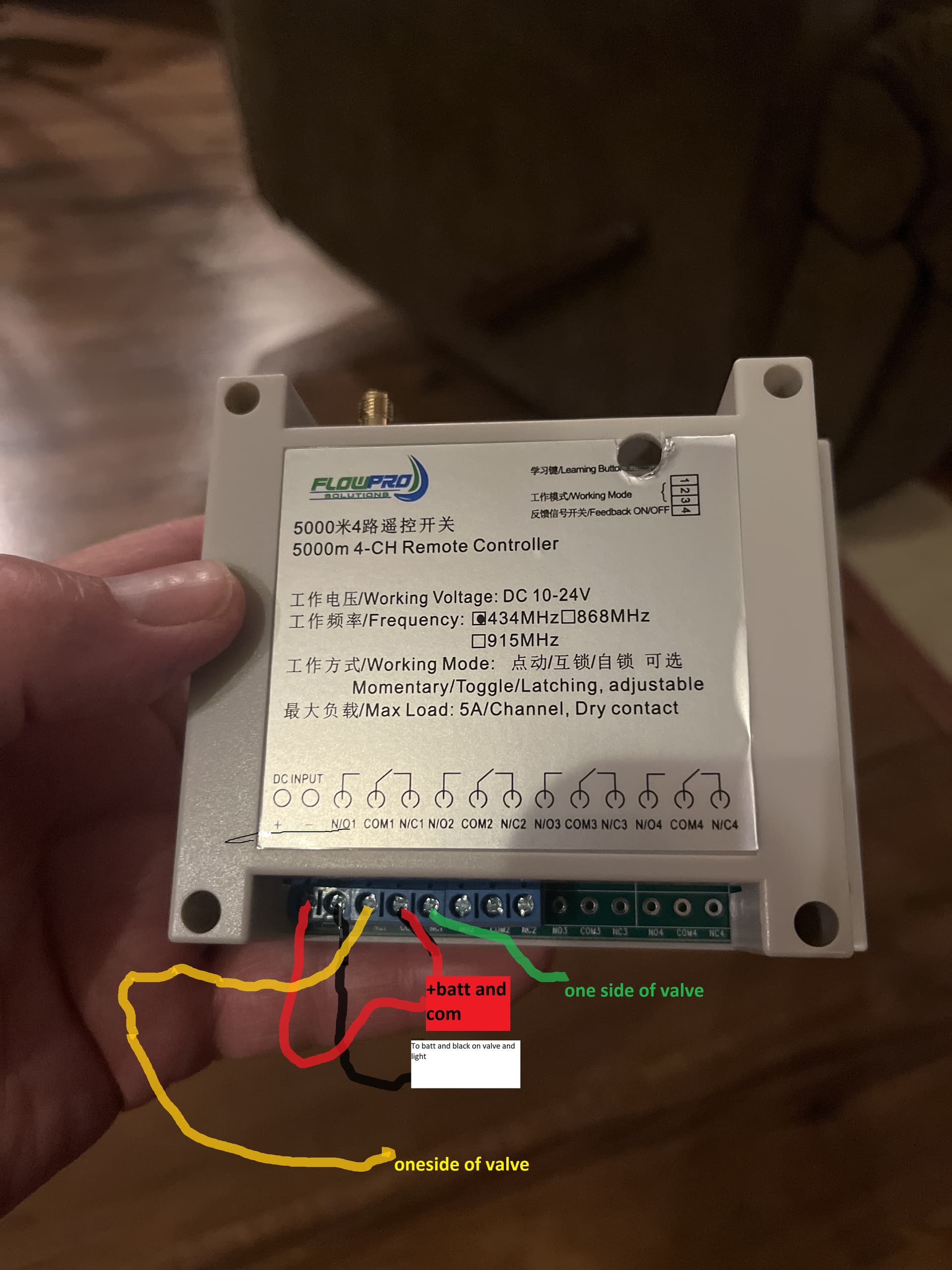

Ok now that I have that. follow drawing. you will have to hook up you light to which ever side of the valve you need to see.

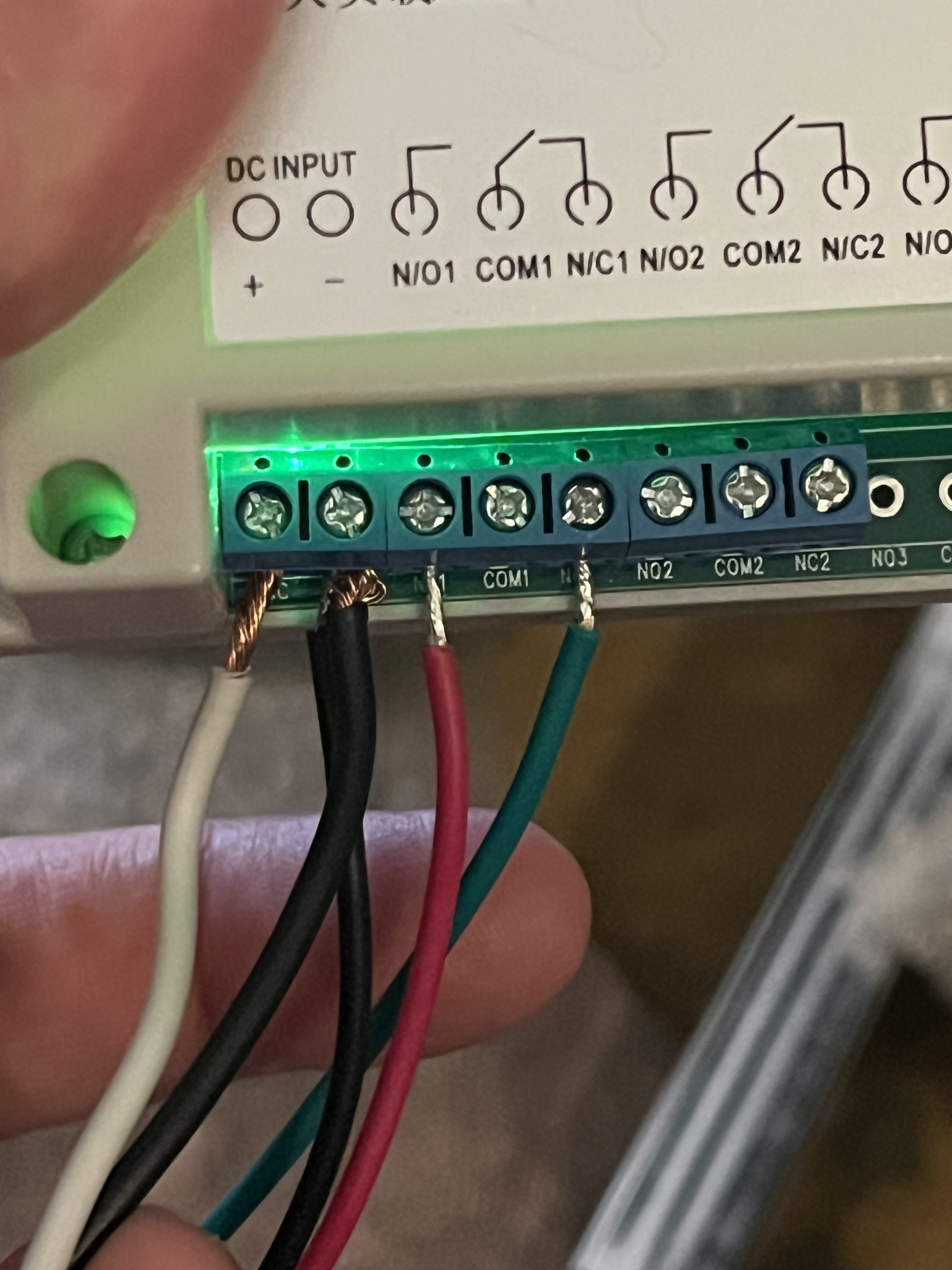

Thanks for the effort, still nothing
I’m not worried about the strobe light right now, just trying to get this actuator to even do anything.
you did not add the jumper from the positive to the common
It’s alive!! Holy cow thank you so much, I was about to lose my mind! Thats what I couldn’t figure out, why those other connectors weren’t putting out voltage
