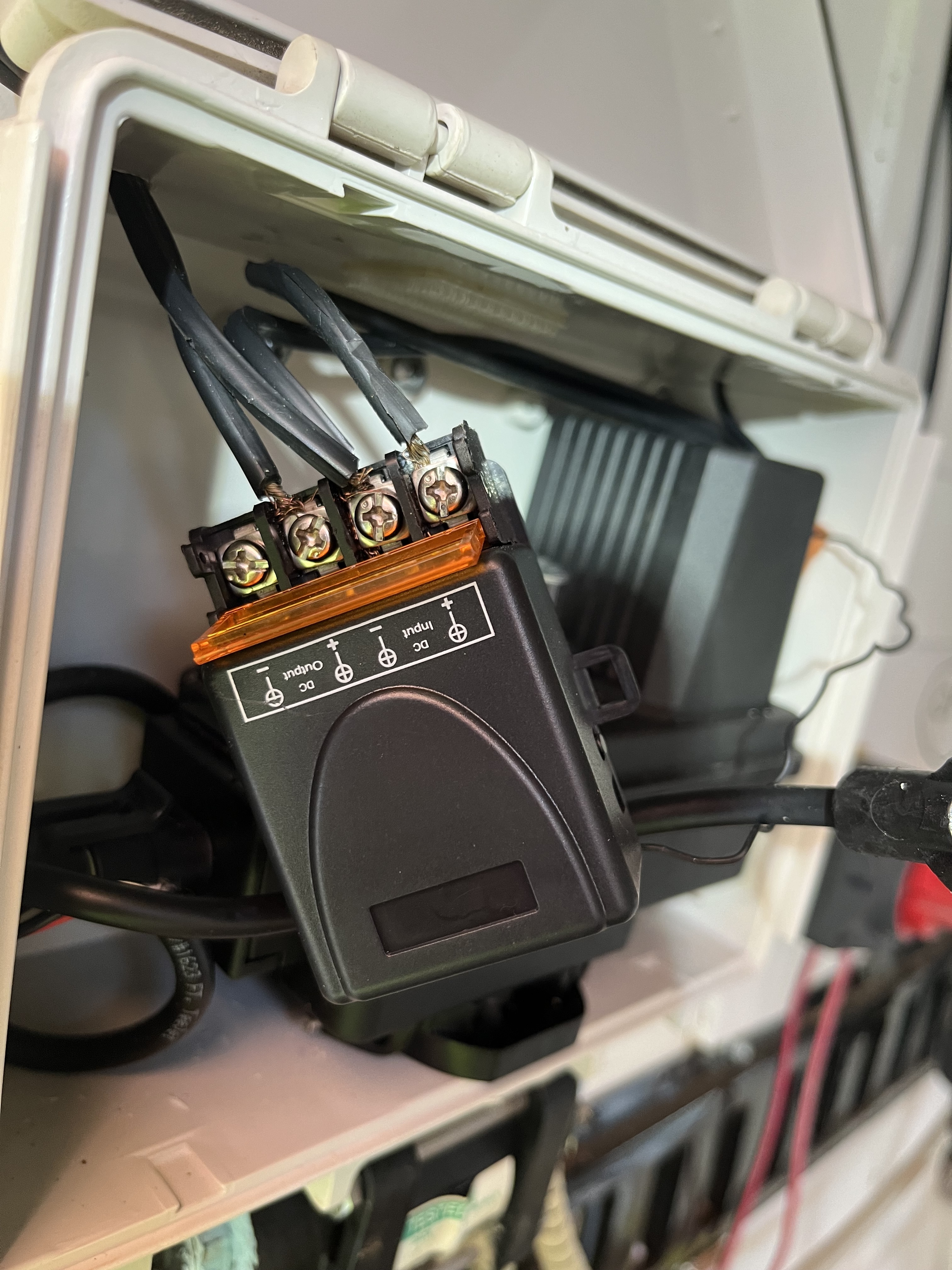

Unless I’m missing something. You’d just put 12v from your battery to the ± on dc input and then your ± dc outputs go to the valve and strobe light. Push on, voltage goes to valve and light. Push off, voltage is cut to both

I you need a new remote here is the one i would get . And wire it up with all 4 wires properly Two to power and two to the light and valve.
That’s for AC power, isn’t this a 12v system?
If you go to the link you will see dc selection there
My bad, didn’t see that :+1:
Thanks for the link! Wish I had seen this before I went ahead and ordered one from Flow Pro😑
If anyone can take a pic of the receiver wiring I would appreciate it.

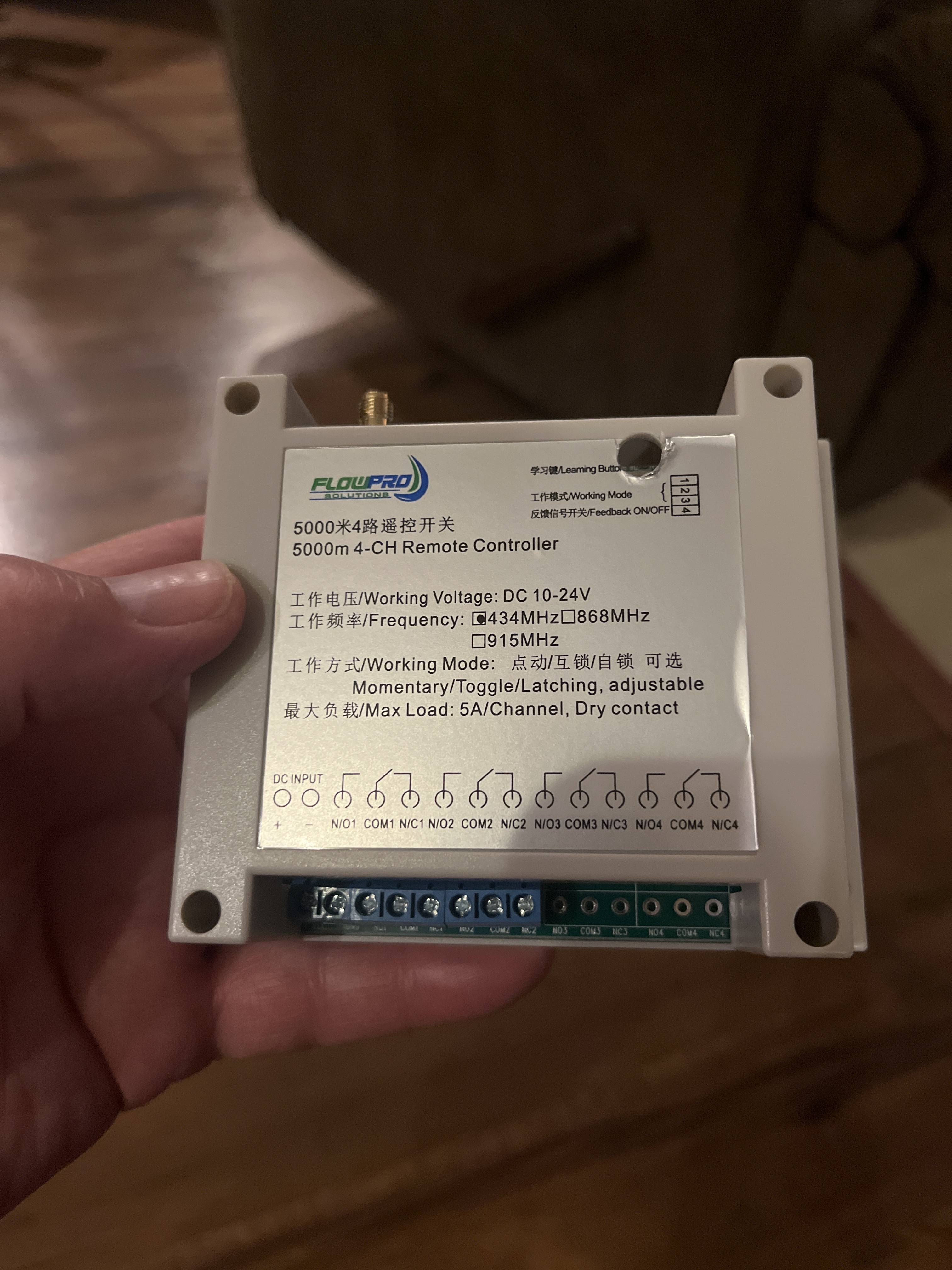

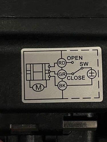

well let us start with how you want it to work. Think of those power is just that power 12vdc The next two spots are just a switches on/off or off/on depending . That can have can also control direction of a valve having which way your valve is setup. I personally would need to see the wiring diagram for the valve to be able to tell you how to wire them up. Since I built my set up not bought it together. those flowpro setup are way over priced for my pockets.

I paid $170 for the actuator and printed mounting block. I realized my receiver won’t work with it so after talking with the guy at Flow Pro I bought a waterproof power switch, receiver and two remotes for about $130.

Here’s the sticker on the actuator.
