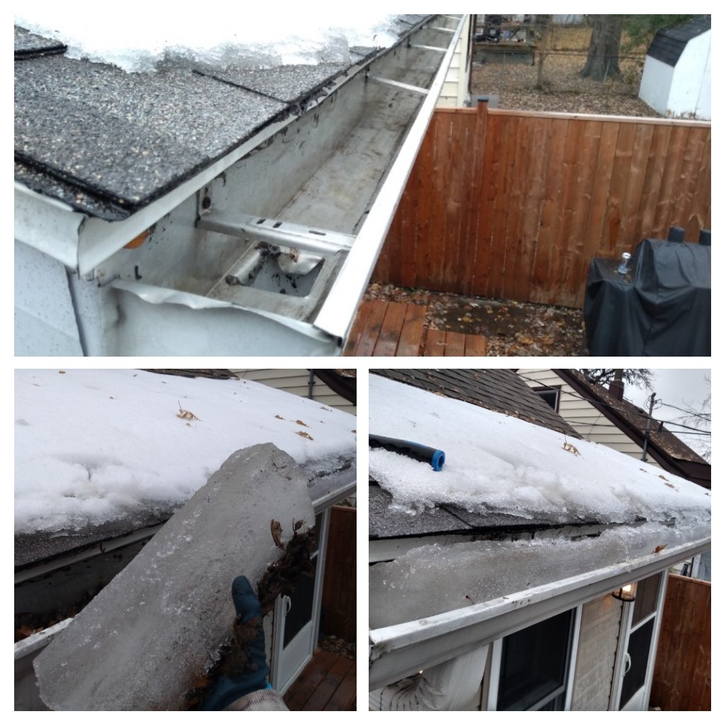

Gutter cleaning includes removing large chunks of ice?
It did yesterday lol. It was only like that on a 8-10ft section on the back of the house so I chipped away at it for a couple minutes and pulled it out in pieces. That was a lot of weight in the gutter.
But for real, is that a normal part of gutter cleaning?
Not necessarily but if you show up to do the job and you think you can remove the ice without causing damage, then get it done. We had a bad snow storm last Monday so there was at least some ice in the gutters of both jobs I did yesterday.
It’s been above freezing for most of this week so most of the snow is gone and the ice isn’t stuck to the bottom of the gutters.
One reason why I stopped gutter cleaning as a service. Leaves drop here in mid Nov and coincides with our first hard freeze.
