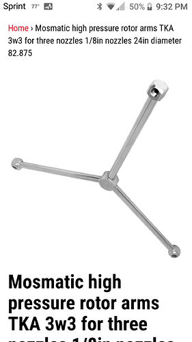

Do you know of a model in particular that has 4 arms? I’d like to look one up. I know Rick had one a while back that had three arms on a single swivel. That’s not what I was envisioning when I responded initially.
the old Landa jets used them and I think steel eagle has a model that uses 4 bars
I don’t see any reason to delete. It’s an interesting topic. Personally I’d like to know more.
Very interesting! So that one has another tip in the center as well if I’m seeing that right?

Some of the upper end NT have as does mosmatic. They clean great. Guys that have the old Landa jets that William referenced love them, though I didn’t know they had the 4 arms, but they clean like crazy, just bulky and heavy.

I’ve always wondered what the 1/8" nozzles were for…lol
