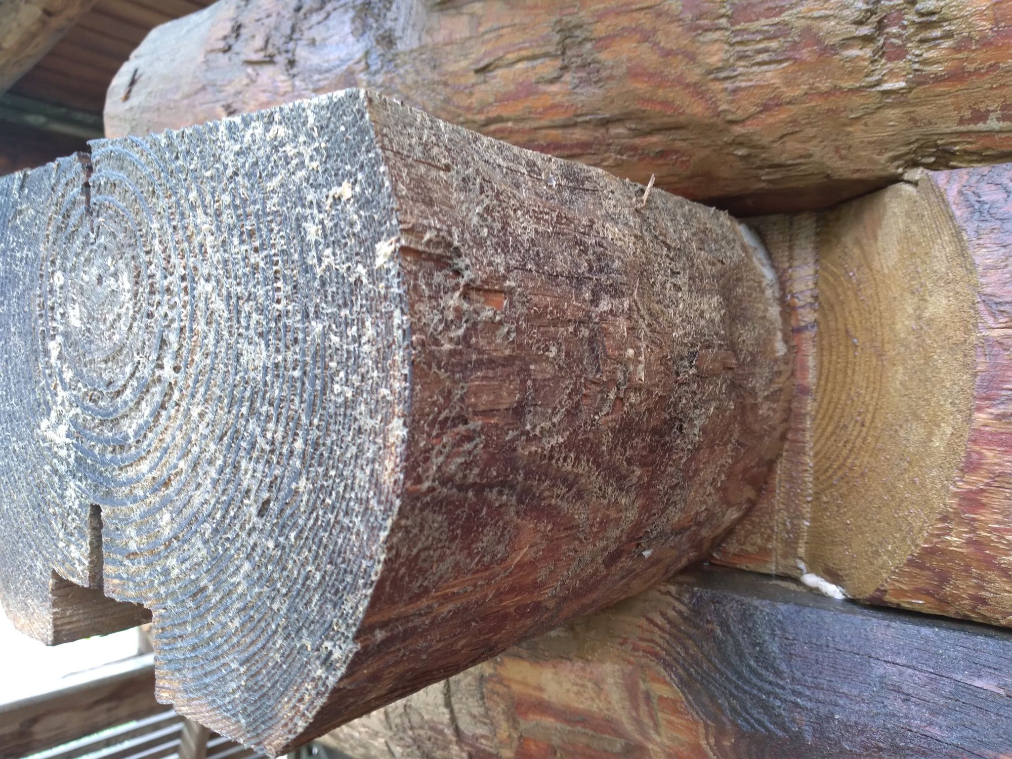

Washing a log cabin today. Prepping for stain. Used F18 Max (sodium hydroxide) 6-8 oz/gallon of water via pump sprayer. Previous stain came right of and the wood looks much better, but for some reason it’s covered in this fuzz. It doesn’t look like furring, and I didn’t use very high pressure when I rinsed it. What do I do to get rid of this? Will it simply need sanding prior to staining? I am not the one staining by the way.
wood can fur, osborn brush will take care of it. Need a variable speed grinder and the brushes aren’t cheap.
Hit up the cabin king @SurfaceTherapy or @MDA1775 the texas stain master
Osborn brush Abrams uses them, wizard of wood.
I’ll leave that to the staining guy. No time for that. Lol
Blasphemy!
These are osborn brushes.
That is a lot of fuzz, either too long dwell time or mix was pretty hot.
On another note, did you acid wash that after? Wood looks pretty dark in the photos.
Would a hot sodium hydroxide mix do that? I know Sodium hypo would, but I didn’t use that here.
Most definitely
Interesting. I am going back to finish the job tomorrow, I’ll see if I can test a cooler mix elsewhere. The wood seemed pretty old. I believe this fuzz is everywhere, even places I used no chemicals at all.
Looks like too hot a mix. that exactly what wood looks like when it is. Always do a test spot. It’s not an exact science and measurements are usually just guidelines. Just for your info - Hydroxide is a higher PH than SH.
Thanks, good to know. I doubt I’ll do another one of these. I actually turned this job down and told the customer I’m not educated or experienced in stain stripping, and he insisted I do the job anyway because of my reoutation and equipment. Made it very clear that there was no guarantee as to the results.
