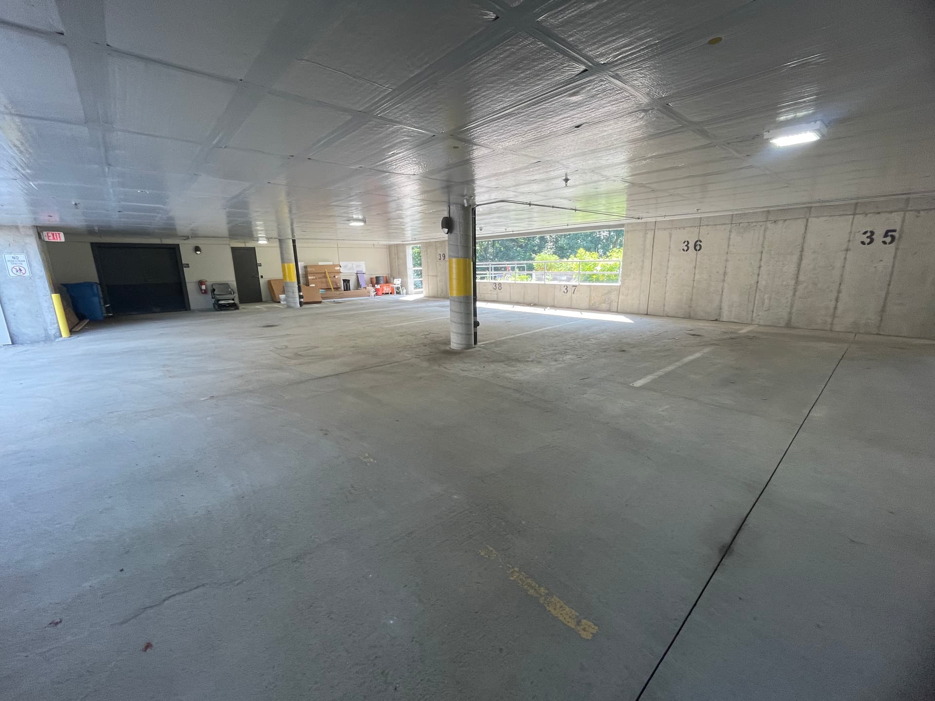

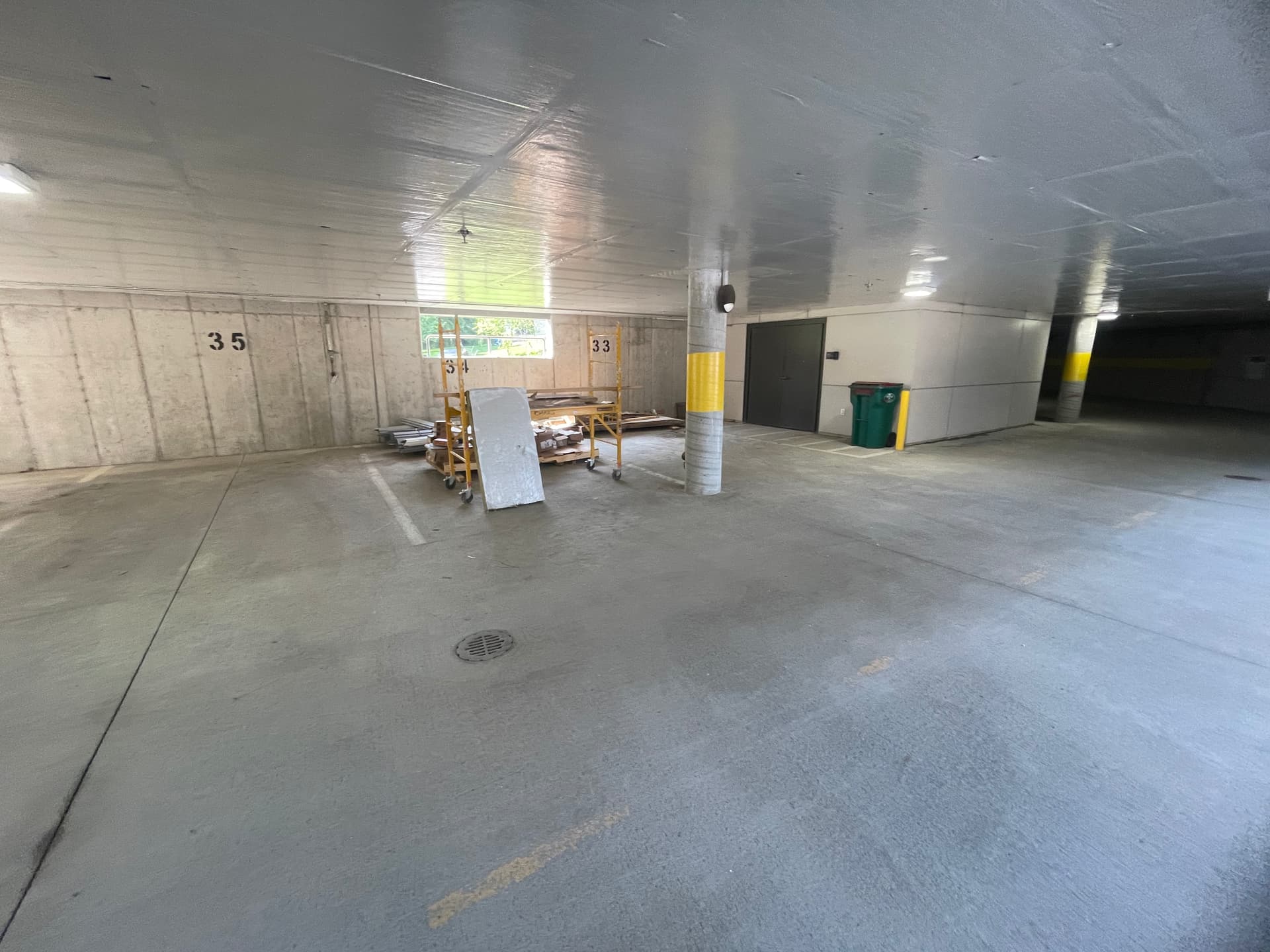

In the market for my first real surface cleaner, believe it or not. Have a small garage floor to wash. (~3600 sq ft)
For very occasional use, which will fit me better? The 16” Ultra Clean, or the 19” Classic?
Y’all know what I’m running: iGX700 with a Udor 8@3500 gear drive.

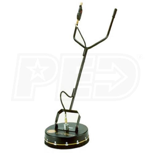

I like my Classic. I’m not sure how much 3 more inches will help you tho. You can get the Classic with an aluminum cover which is nice. I have an extra aluminum cover if you want it. I accidentally ordered orange the first time when I wanted blue.
I have the classic extreme, love it! Very heavy duty…
19in ultra clean
Gotta link for that, @Innocentbystander William?
Is there a reason you prefer the ultra clean over the classic? Besides price?

Couple things.
The Classic has narrower handlebars, I’m not terribly overweight but couldn’t fit between them. The Ultra lets you walk between them.
William suggested using a 2315 gun in place of the straight pull and it makes a big difference in comfort. i don’t think you can add one to the Classic.
The 19" lets you add a 4 nozzle bar, highly recommended.

If you get the classic you have to do a lot of fab work to remove the built in gun so your trigger gun can plug into it.
