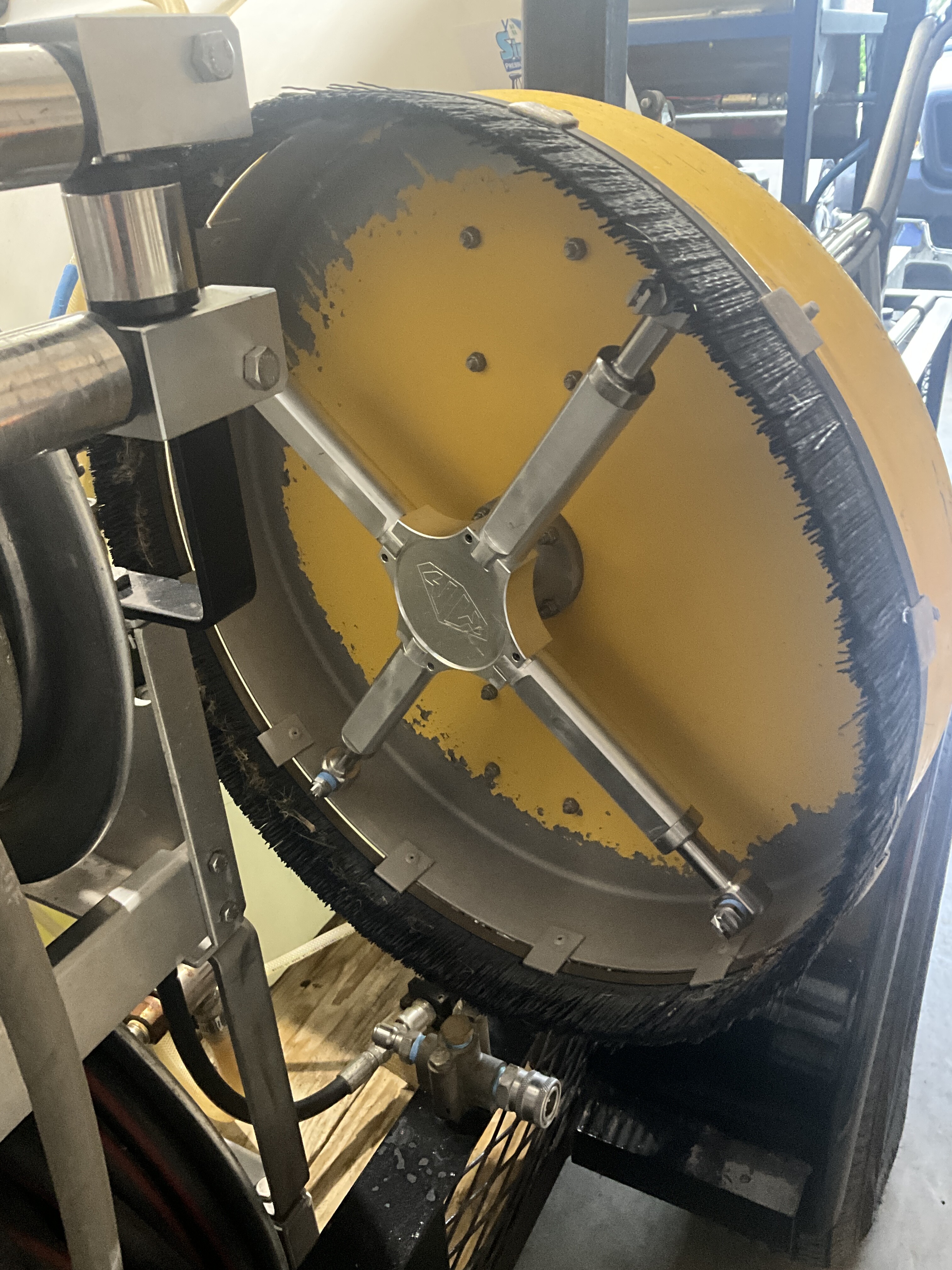

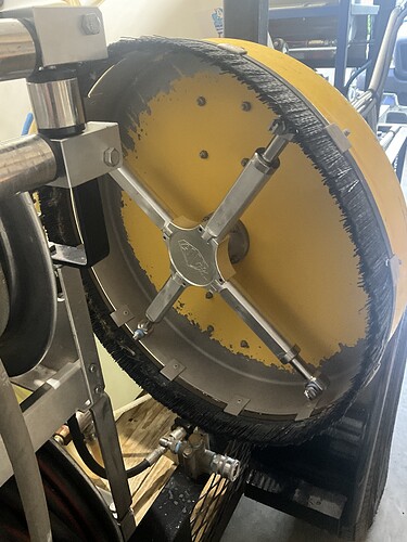

XForce Spray Bar By Whisper Wash is a game changer to me, not sure if any you guys are using it yet. If so, what do you think?
What’s special about it?
He’s going over it twice in one pass. Too bad a 16 inch isn’t out there to be had.
What @TheWizard said….it seems quieter too. Very well built, just really smooth on the concrete. Just was wondering if anyone else had one….
Did you use a 4 nozzle bar before this thing? If so is it that much better? It looks pretty neat. Don’t think I want to know what it costs. I was pricing out surface cleaners and they have gone up in price since I bought my last one.
Yes I did use a 4 nozzle bars…….this just does better coverage. It’s a big difference to me, so much so I just bought another for my 24” Whisper Wash. I initially got one for my 19” extreme whisper wash, they run around 360.00 but built amazingly nice and tough….will last a long time. Ends can be replaced, I have the performance stainless steel ends so it will be a long time before I need to replace them, unless you damage one for some reason. Nice upgrade for sure.

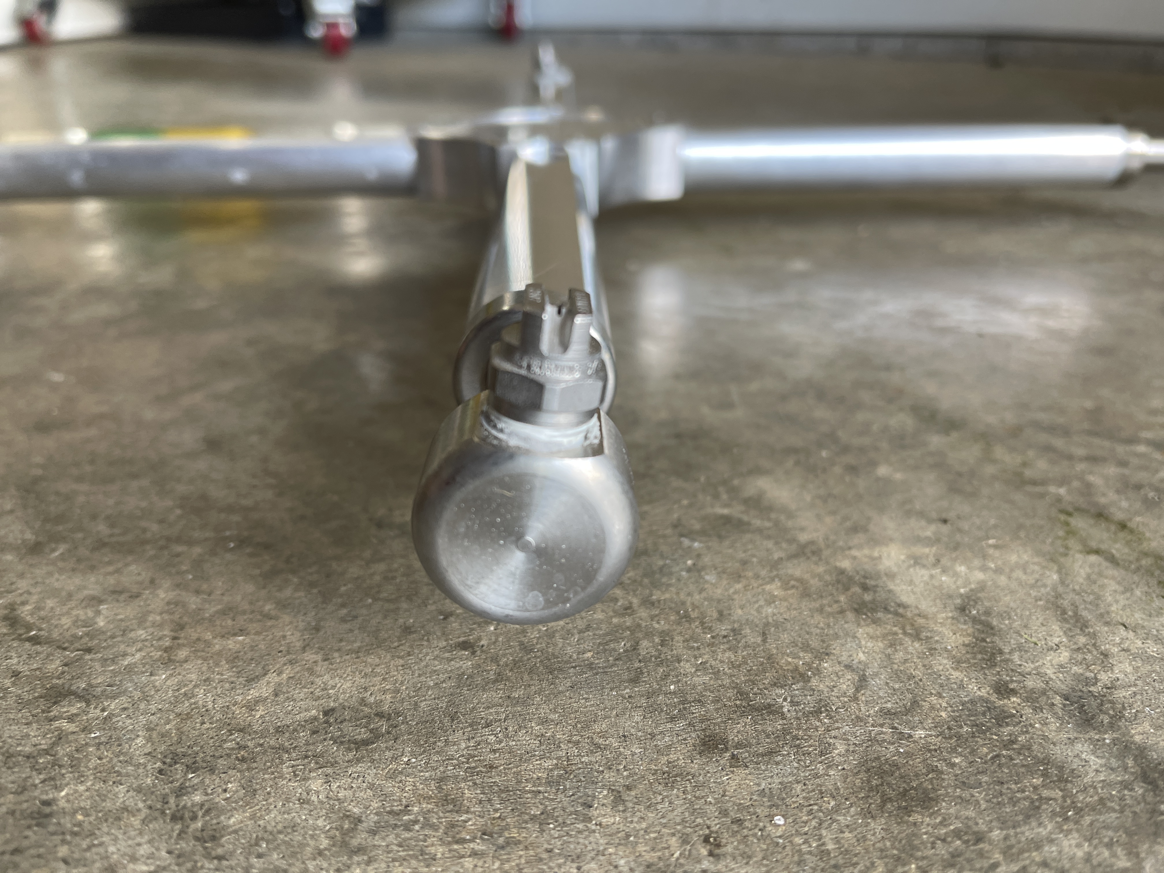

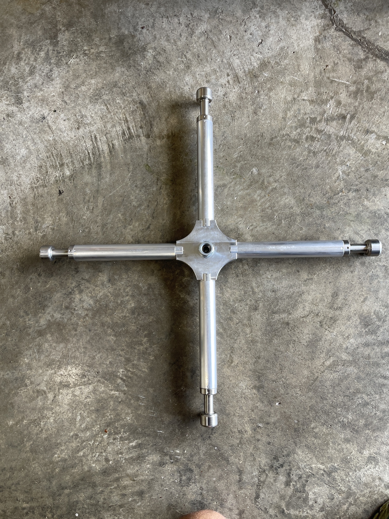

Here are some pics of the bar. It weighs around 4.3 lbs with the tips on them. My old single bar was 1.8 lbs. so a bit more but I don’t notice it honestly. Tried it out real quick to make sure it was balanced good and it was. This thing is so smooth, makes me think of that Lexus commercial years ago with the glass of water on the front hood with engine running,
. Not an ounce of vibration, really amazing stuff. My single bar had a little vibration going on, when new it didn’t but over time the aluminum ends wear differently and I think it causes slight variations, nothing horrible at all but once I got these it was a big difference. Anyways….as you can tell I like them,

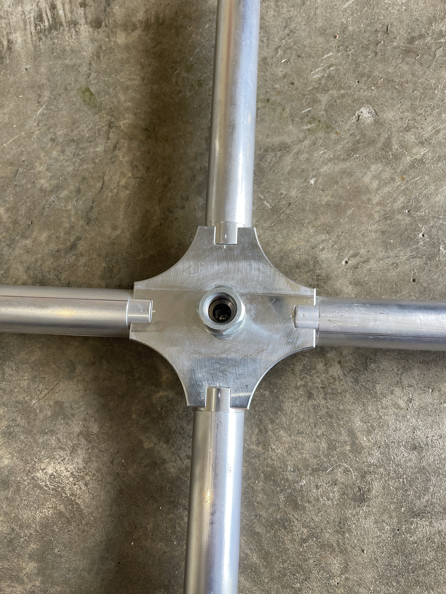

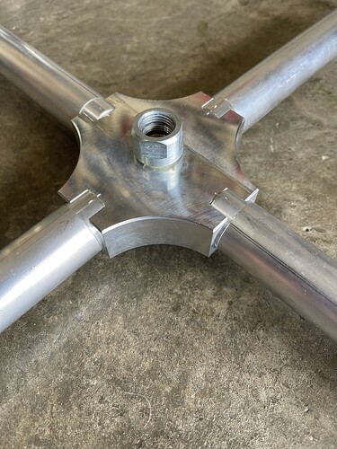

More pics….it also has bigger guts, maybe 1/2” so flow better. Got 150 psi better for some reason, not sure if from the the larger passages?
Less restriction would give you less psi. Probably got more psi from the new nozzles. Let me know how you like it tho. We just got the new Ares 24” with the “4claw raptor bar”. I haven’t gotten to use it but my guys say it cleans much faster than my whisper wash with the old 4 nozzle style. Id consider changing those ones out
Yeah that’s true….i had older nozzles in my old bar. These are new….these new bars clean better and you can move faster. Big difference to me, I like it on my 19” WW so much I decided to get one for my 24”. I’ll do some videos soon to show the performance of it. I used the single bar 4 nozzles previously for reference.
