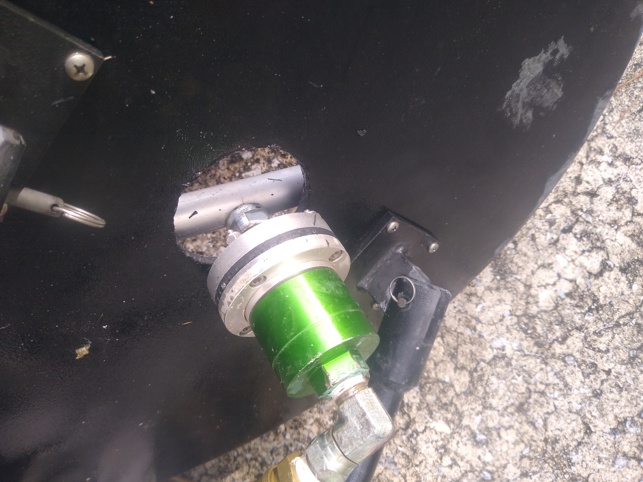

Has anyone seen this before?! The aqua pro skirt broke where the swivel connects to it.

It was crazy, going along on a flat driveway and suddenly exploded. The swivel and bar are still in perfect shape. So weird.
That is weird…haven’t hit any curbs or anything with it?
Throw that 90 degree fitting off a cliff garry, it has no place on a surface cleaner. On a plastic surface cleaner all it’s doing is fatiguing the centre every time you pull the trigger. If lifting is an issue put a small weight on it, you don’t have to get ridiculous and sand bag it, it doesn’t need a lot of weight to keep it down.
stop that nonsense. Elbow is the way to go @garry.cooper contact whisper wash and they should replace it free. If not, ask them if a 19 inch eagle wash shell will fit it. If so, I’ll mail you one.
The Classic comes in an optional aluminum skirt.
We have a number of sc for years all with 90s and never had an issue. It’s odd.

Plan to call ww in the morning, happened late in the day. Thank God for having a spare.
