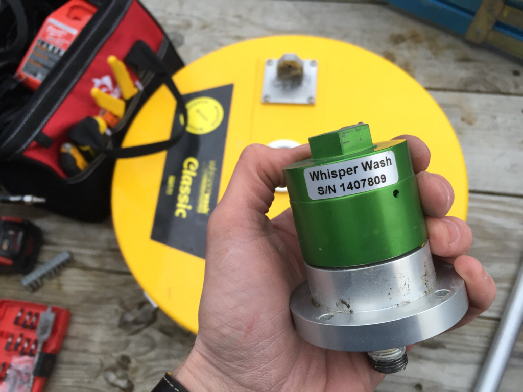

My Whisper Wash Classic is spraying out of two holes that are located on the opposite sides of the green piece at the base - see pictures. It’s easier to show than to describe.
As a result, the pressure at the nozzles drops significantly. So obviously it doesn’t clean as good as it should. Which is not good :slight_smile:
What are these holes, and how can I fix it? Any ideas?

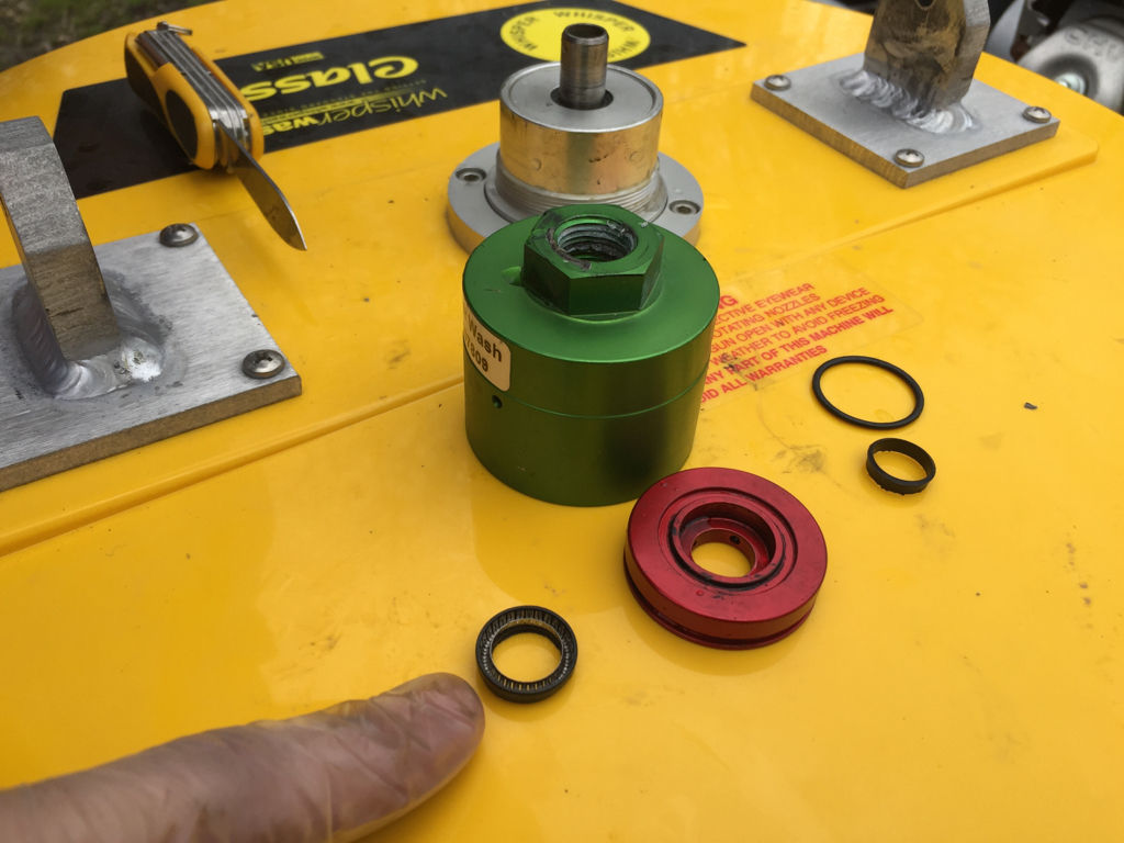

I took this thing out (see pic). I don’t think I can disassemble it further.
Gonna call PressureTek to see if they have a replacement part.
Alex @ Nothside Power Washing
So it appears that I’m gonna have to order a new swivel assembly ($297 from pressuretek). It is what it is, I suppose. I can’t live without my whisper classic!

Alex,
We just had to replace the bar that is in the swivel assembly earlier in the week. It’s not too difficult to un-lock it (green from silver) however, there is a pin lock on the ball baring’s that was very difficult to remove, but you wouldn’t have to mess with that. I would look to see if its just the rubber 0-ring. There is a 0-ring at the top of the ball baring’s that could have been broken and can easily be replaced. Check that first.

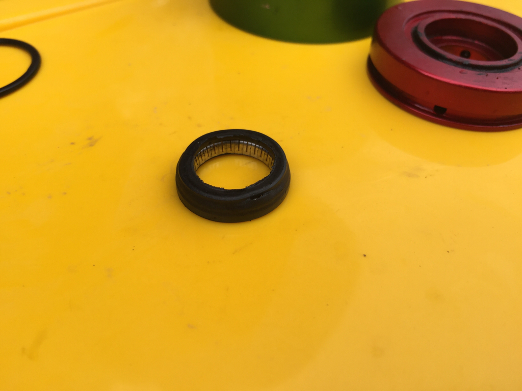

I took the swivel apart. The seals / o-rings appear to be fine. It’s this little black piece (see pic) that’s torn.
I doubt pressure tek has repair kits. But I’ll call them up. As well as look online.
OK I ordered a new seal kit online. $49 with shipping. I’ll post here if this resolves my issue.
