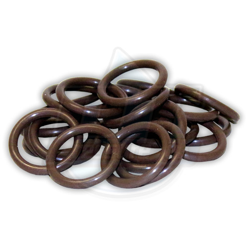

If using hot water…1/4" Couplers (25) Pack Viton O-Rings - Pressure Tek
If not…1/4" Couplers (25) Pack Buna O-Rings - Pressure Tek
