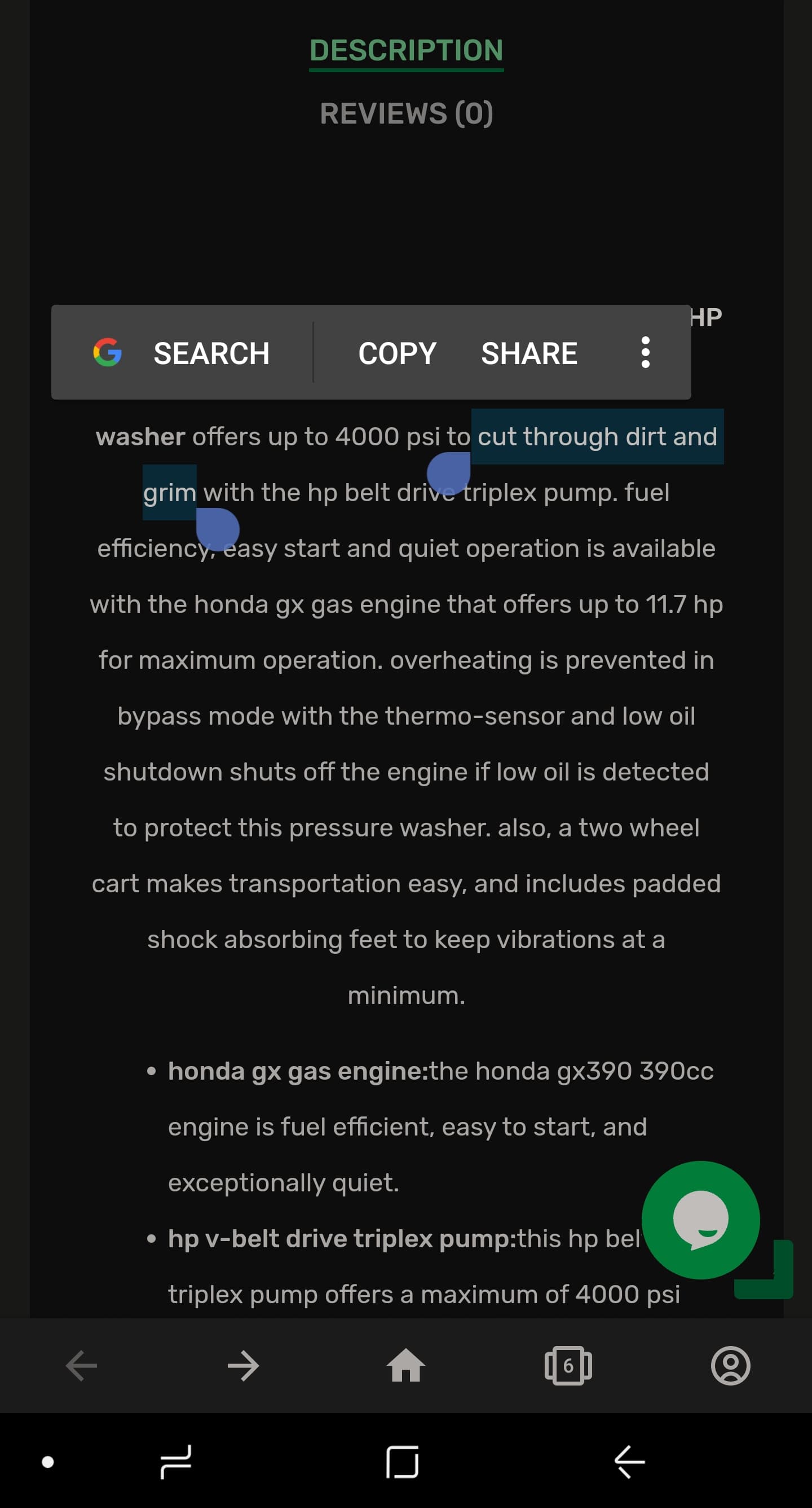

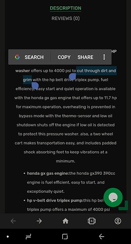

Thanks for this. Definitely saving this one. First I’ve seen a belt drive under 1k

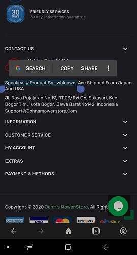

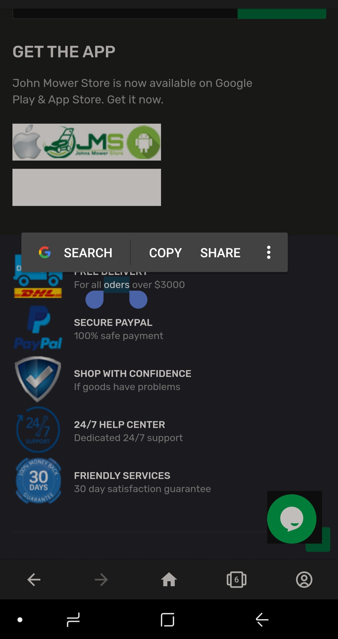

@ShoelessPeanut Hold Up Amigo! I looked at the site when I got back to my pc and they have a few things going on that make it look fishy!! I WOULD NOT take a chance that they are a legit vendor. BUYER BEWARE
YUP it’s 100 percent a scam site sorry guys
Actually yeah I was just noticing that. Scary stuff
