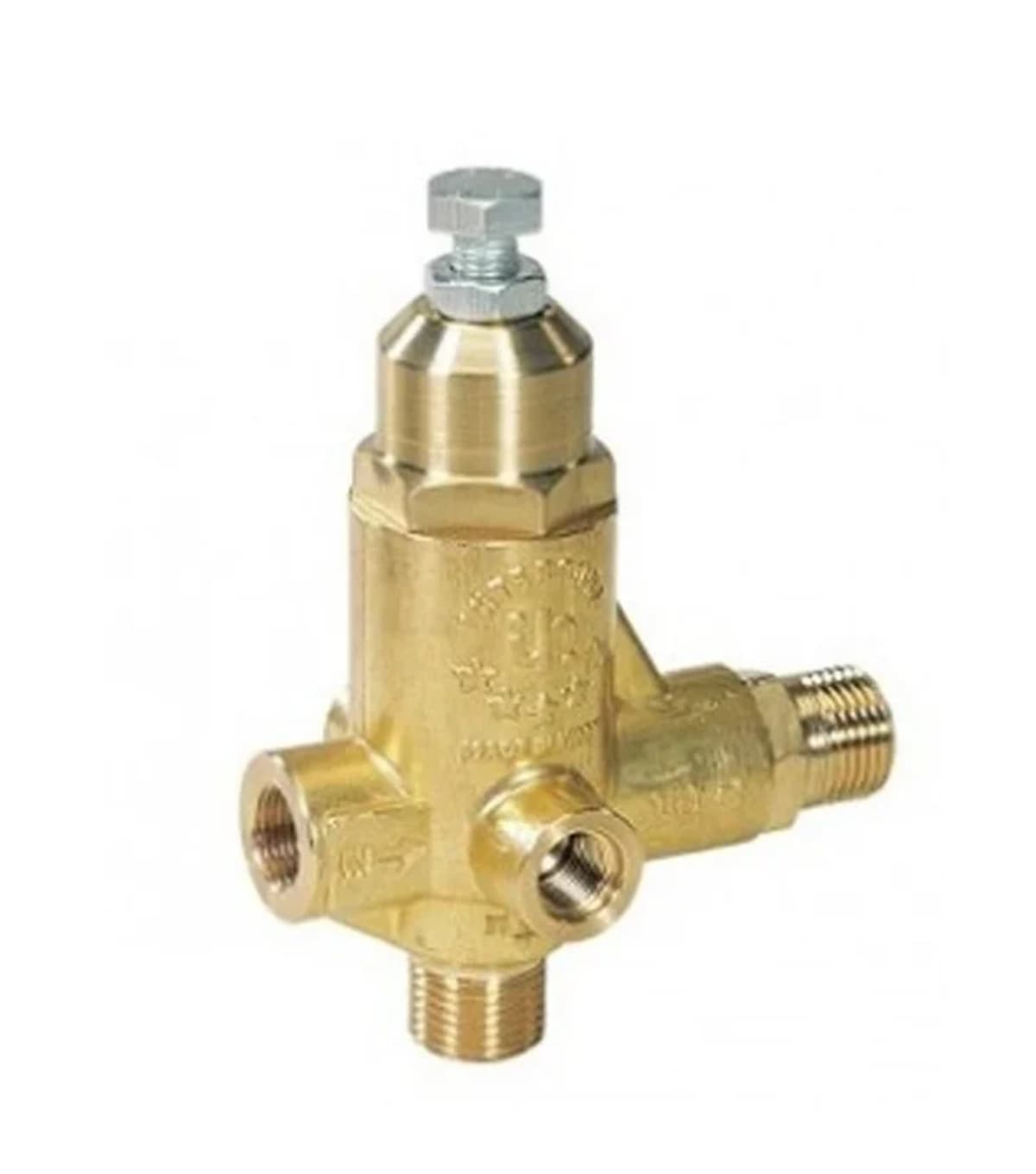

Unloader and block (is there a difference between the zk1 ($100) (EU version) and k1 ($130) (US version), they have different size outlets?) and a battery set up for the electric start are on the top of the list since both will be useful as is and can be reused when upgraded. I’ll look into fuel cell set ups… thats probably the way to go.
Maybe the threads are different. Mine came with BSPP threads but I just added some threadlocker blue & tightened the daylights out of it. I had to add a couple adapters to make it work. I already had a deep cycle battery for the 12v setup & it works great for electric start. A GX390 has to be gravity fed for fuel where a V twin has a fuel pump the will pull gas from anywhere.

I keep seeing some with this extra outlet circled in red… can I seal that off if I don’t need it or would I be better off just getting one without it?
As long as you’re spending the money, buy both and let us know how it works out.
Ha, I’ll have to read over the return policy first.
