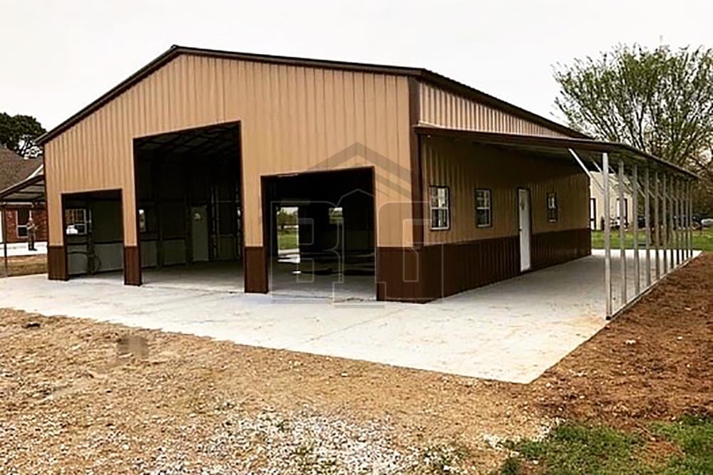

I don’t know if this is just for business or a mix, but in hindsight I wish I would have put the overhangs or run ins on it. I can’t remember what they are called, but it looks like the sides on this thing:
I would have also put in a shop sink, a deep one like a laundry tub. I only have floor drains. I put in a bunch of windows and I am glad I did, lets in a lot of natural light and lets me ventilate the space without opening the garage door. Also a chain hoist and a steel beam trolley. Tractor stuff is super heavy.
