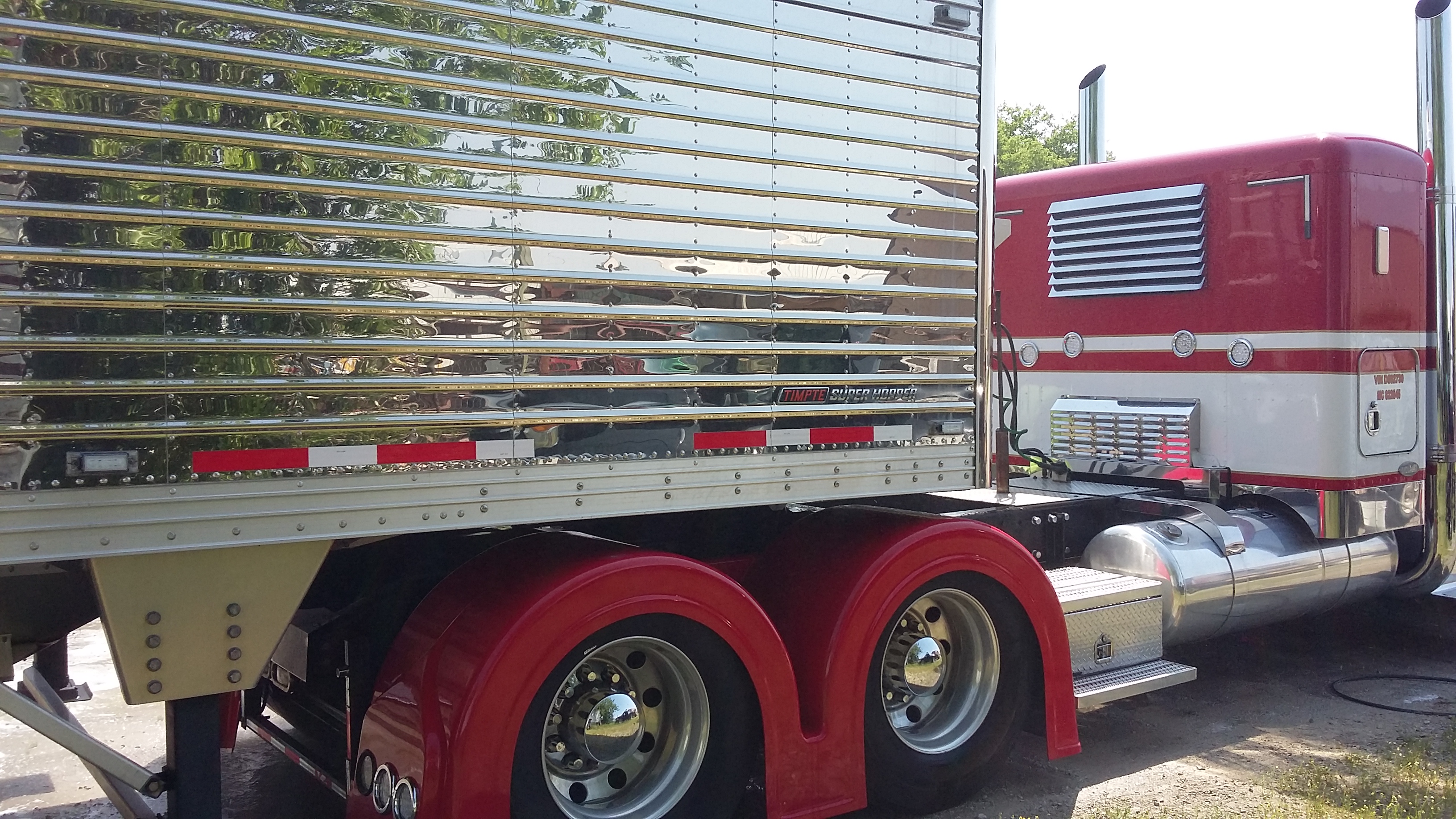

This is one of rigs we wash and polish. Time consuming as heck,but it pays pretty decent and we enjoy the end result after a hard day.
