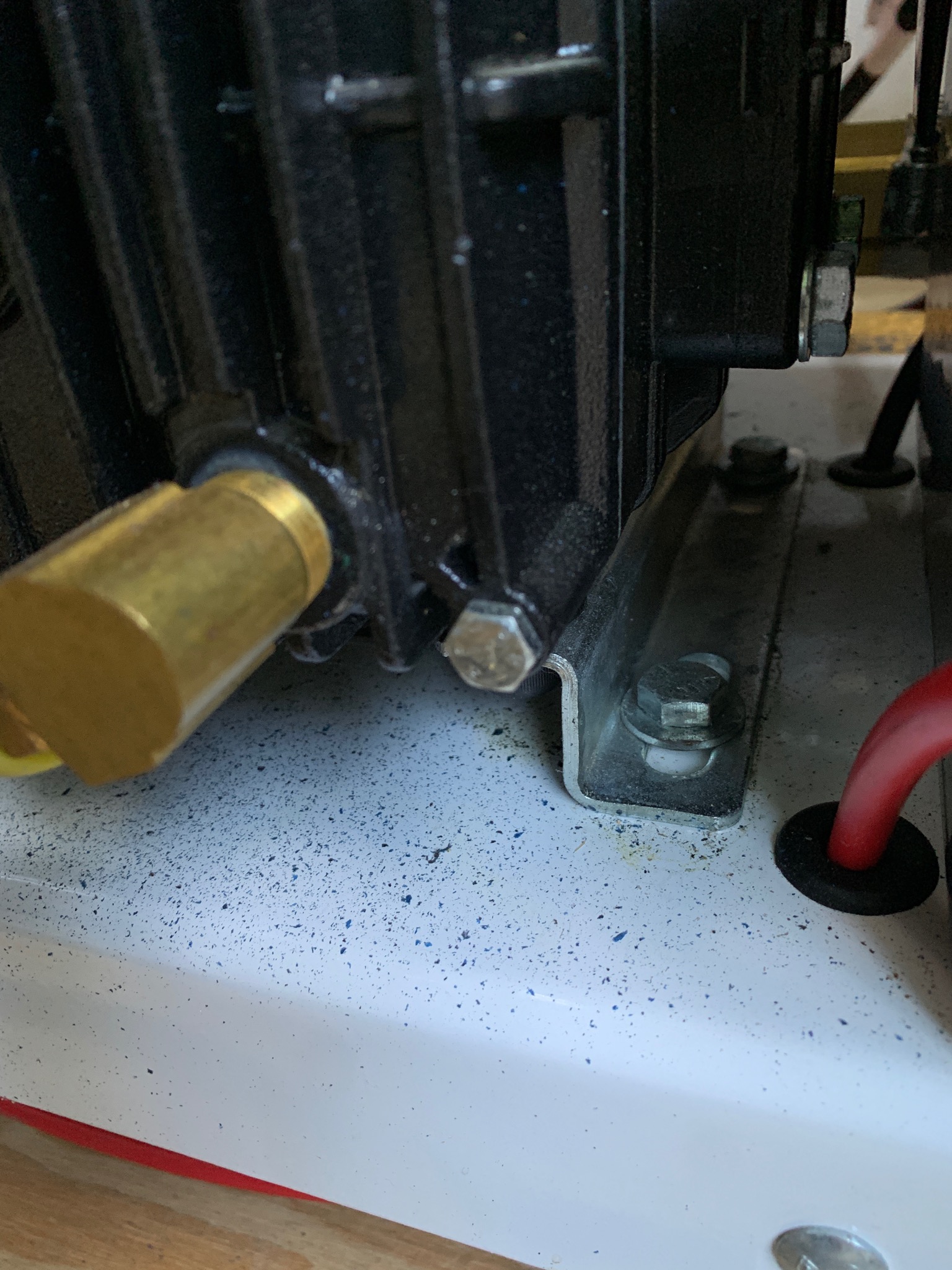

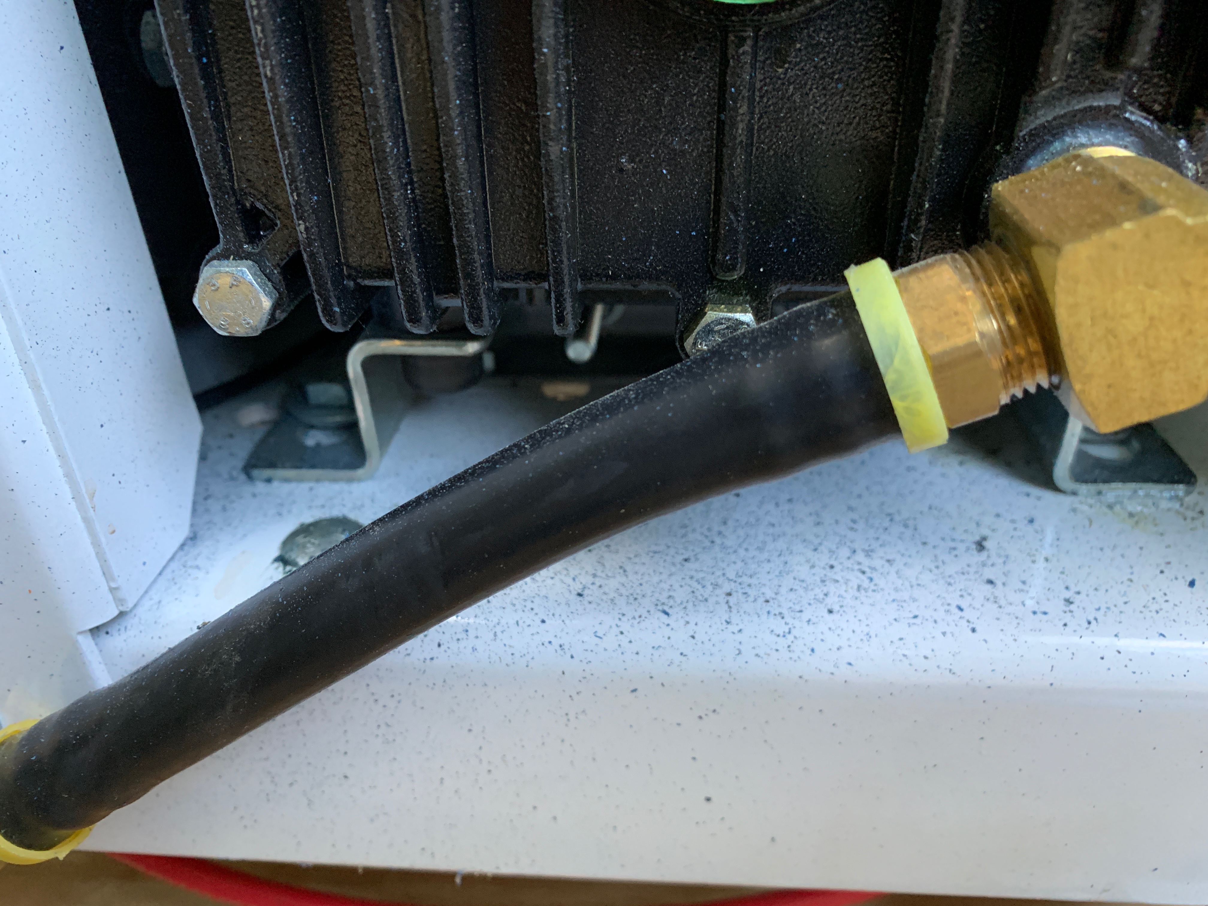

Man this is bad can’t keep this up. This concrete was about 20 yrs old
Then I noticed belt dust (lots)from the poly chain sitting on the pump frame
Don’t lower the throttle. You are killing the engine.
Don’t throttle the ball valve. You are killing the unloader.
Don’t clean concrete that you can damage
Don’t buy a machine with a poly belt. I literally just sold two with barely any hours that a crew bought and didn’t tell me as about.
IB
In your opinion what’s your issue with poly chain?
Changing it?
Other than me tilling concrete with it, I have no complaints yet. I’ll assume the dust was from me lowering the idle and cocking the ball valve I assume never seen it before that job.

You have a machine with less than ten hours and you have belt shavings/dust? That would be a problem for me.
Only after the last 90 minutes of 3/4 throttle and a choked ball valve it was clean before that.
