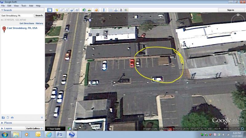

Are you planning on just doing that little area? or the entire side of the building? That building is 140’x30’(google earth measurements) and three stories towards the front. Set a minimum charge for your work if you are just doing that small area. Customers will abuse you if you charge too little or do partial work. If you have any questions on what this market can support just reach out to me.
