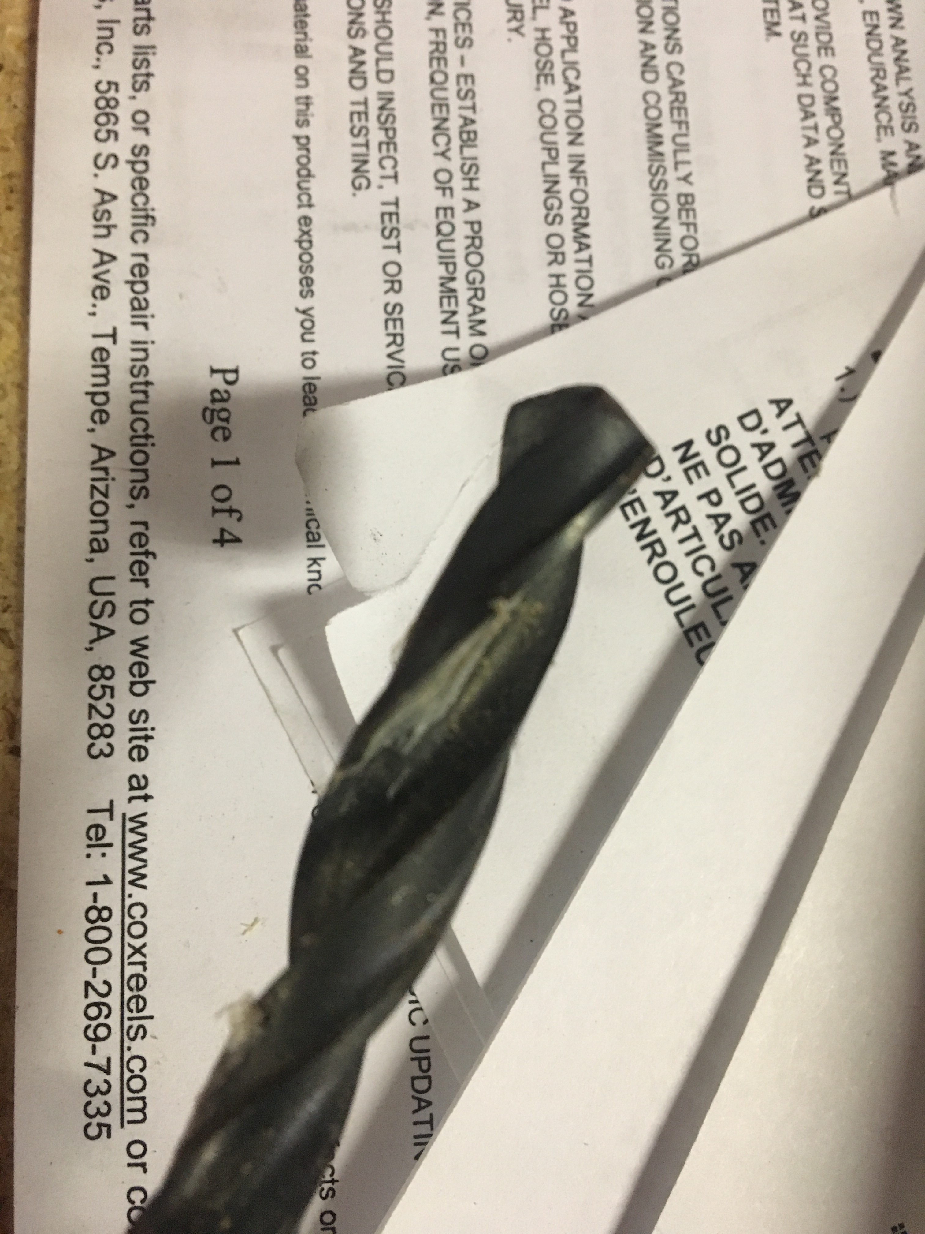

What kind of drill bit is this?
Found this in an old tool bag. Not mine and no clue where it came from. What kind of bit is this and what’s it for?

Alright jokers… it has a raised “bump” all the way down the cutting channel I haven’t seen before. (Most) engineers don’t just throw stuff on other stuff Willy nilly like.
I have a number of the raised edge bits. They are metal bits with supposedly less drag than the solid ones. They do seem to cut a little faster and last a little longer before they need sharpening but that’s am impression nothing I have ever tried to measure.
This one has nylon in it. Doesn’t mean whoever was using before I accidentally stole it was using it the right way. Lol
I’m gonna chuck it into the drill press and see how well it cuts steel angle. I may need it soon.
Haha, Ok I stand corrected. That is different and I don’t know what it is.

It’s a masonry bit. For drilling bricks and tiles
that is what i looked like to me, they do have more of a sharp corner with a ridge…
All my masonry bits have a larger tip on them than the drill bit body. I didn’t see that on this bit. The nylon insert is different though, didn’t pick up on that before. That may make it something else. IDK
The one time I feel confident enough to respond. It’s appears to be to be just standard HSS (high speed steel)
Jobber drill with 118 deg point,with a black oxide finish. for drilling mild carbon steel . The nylon on the outside is put on the Drill by tool grinder, to protect the cutting edges. The Mason’s drill have a carbide tip made for a hammer drill.
