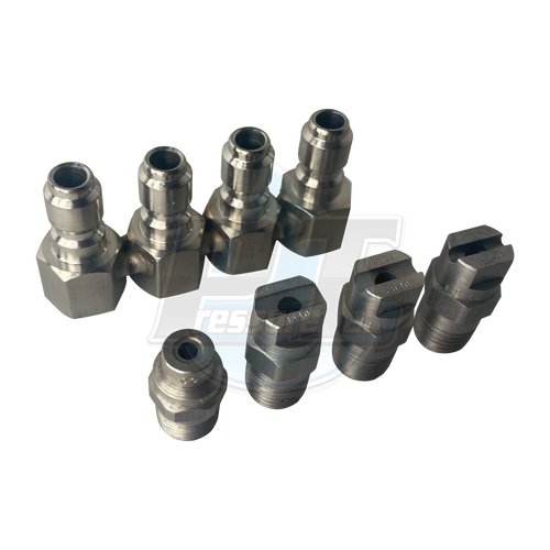

So I’m running a soft wash with a 7gpm North Star pump with 200’ 1/2. What GPM jrod set would I choose.
I give up … which gpm jrod did you choose??
A jrod that probably is to big lol because apparently no one can give me a straight answer. Out nozzle gpm output is approx 3.9 so maybe a 4 gpm jrodz who knows
First of all, Jrod is just a collection of 1/4 ends welded together. Named by Bob at Pressuretek for our buddy Jarrod G. What oyu are probably asking is, “what size nozzles do I need?”. Short answer, you don’t need one. Until you can afford a pressure washer just use a gilmore garden hose nozzle or a 1/4 hose barb. Try to get away from that 12v or air system mess as soon as you can.
