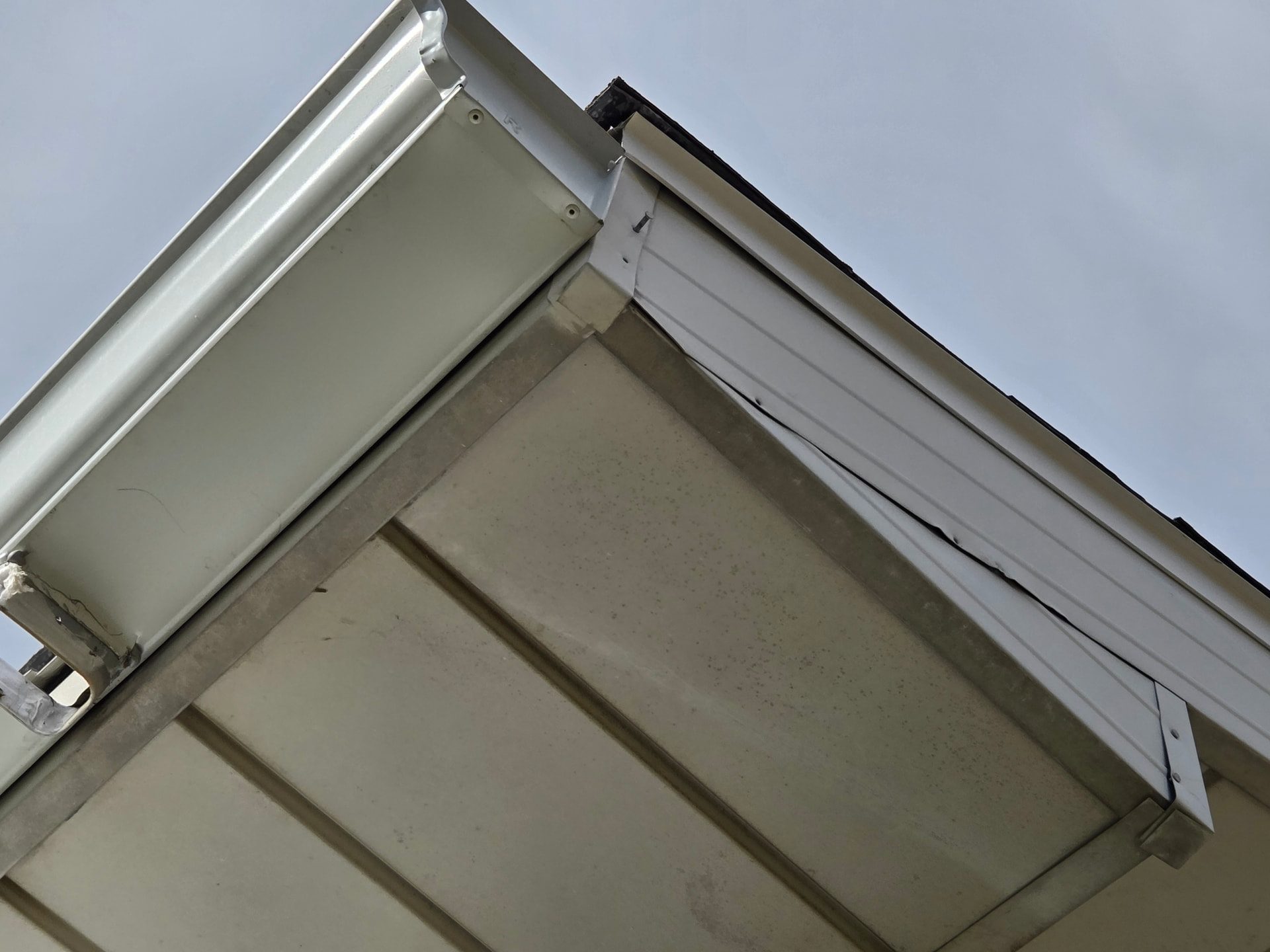

What is this on the white fascia and how to remove?
What’s causing this black staining on the white fascia? I’ve tried my standard SH softwash and scrubbing with LA’s Totally Awesome, but it won’t come off. The staining is smooth to the touch with no raised or rough areas. What chemical would you recommend to remove it?
It looks like the paint is compromised and that’s what you’re seeing. The brackets holding in the soffit panel look oxidized as well.
Did you try a stronger SH mix than just house wash?
Hopefully this is a pre-wash picture as the spots/stains on the white vinyl soffit looks to be what I would consider “normal” mildew.
I’d be hitting that with 3% pump up sprayer
I brush most of the gutters and fascia for the homes I do because they use oil/coal/wood all winter and 1 thermal inversion and it lays on there good. 90% of the time I see that I tell the homeowner that isn’t coming out, might lighten it. Aluminum often goes black on older homes, either it is pitted from the wind and acid rain or the paint is just almost gone. They are almost always heavily oxidized.

Normal house wash takes care of the guy’s problem 99% of the time for me. But like you said, regions are different. Never had any issues with chimney soot around here.
