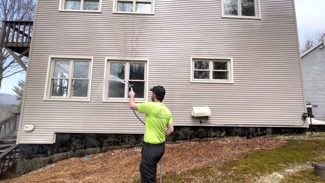

As promised:
I’m taking my time in this video, as there is a lot of junk coming out of the window frames and sills that take time to chase down the siding. But the angled approach seems to help move this debris down the siding more quickly.
-Machine is also throttled down to around 6gpm due to working off a well at this location.
(I already rinsed the top half of the wall prior to shooting the video)
