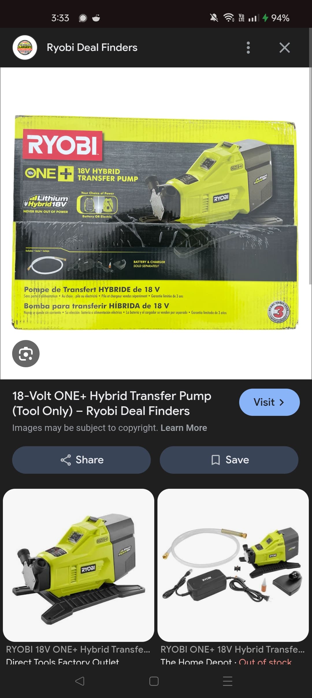

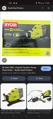

I’ve been using these for transferring. Go through 1 or 2 a year. Are you flushing yours? I do with these. Have been eyeballing the big boy finish Thompson pumps but haven’t pulled the trigger on one yet.
Says out of stock down here. Can’t even order the hybrid. I like it for the little suction head on it too.
I’m definitely going to try one if I can find it.
ohhhh that looks cool! I’m going to look for that. Although it doesn’t get much easier than what I have setup, I just have a 5GPM pump bolted to the top of my buffer so it doesn’t take floor space in the bed. Then I have 2x 1/2” hoses one on suction one on output and I have them coiled up and long enough to reach my SH drum on ground and SH tank on rig. EZ-PZ lemon squeezy.
I like it because I keep it on my box truck and with bigger jobs I can fill my 55 gallon sh tank, and then bring a few 15 gal jugs of SH to top off when In the field if need be. I have it set up to cam lock into sh tank and other side is a drop stick. When don z I just drop drop stick into my 275 water tank and flush from there.
