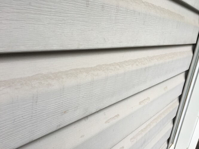

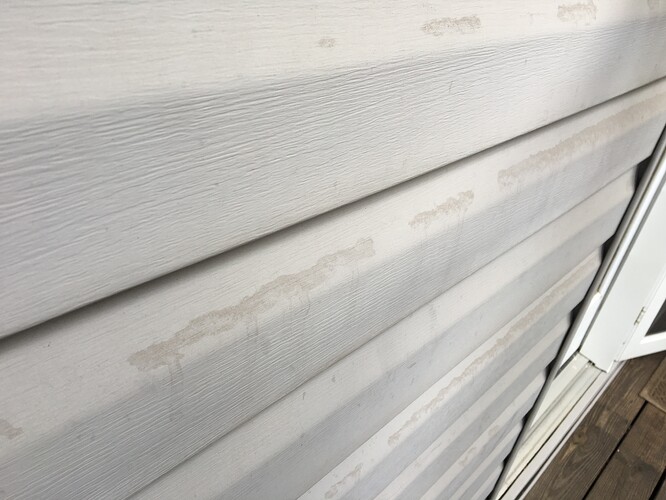

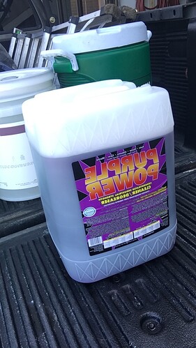

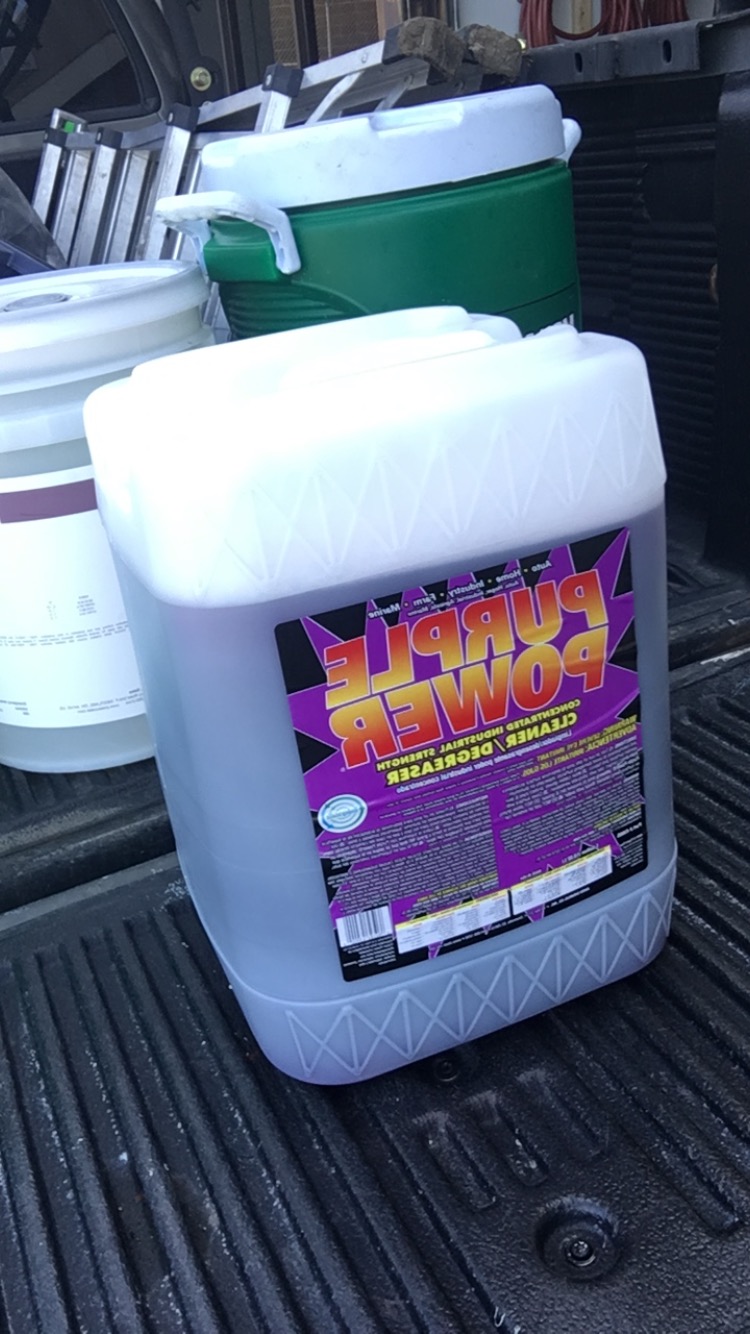

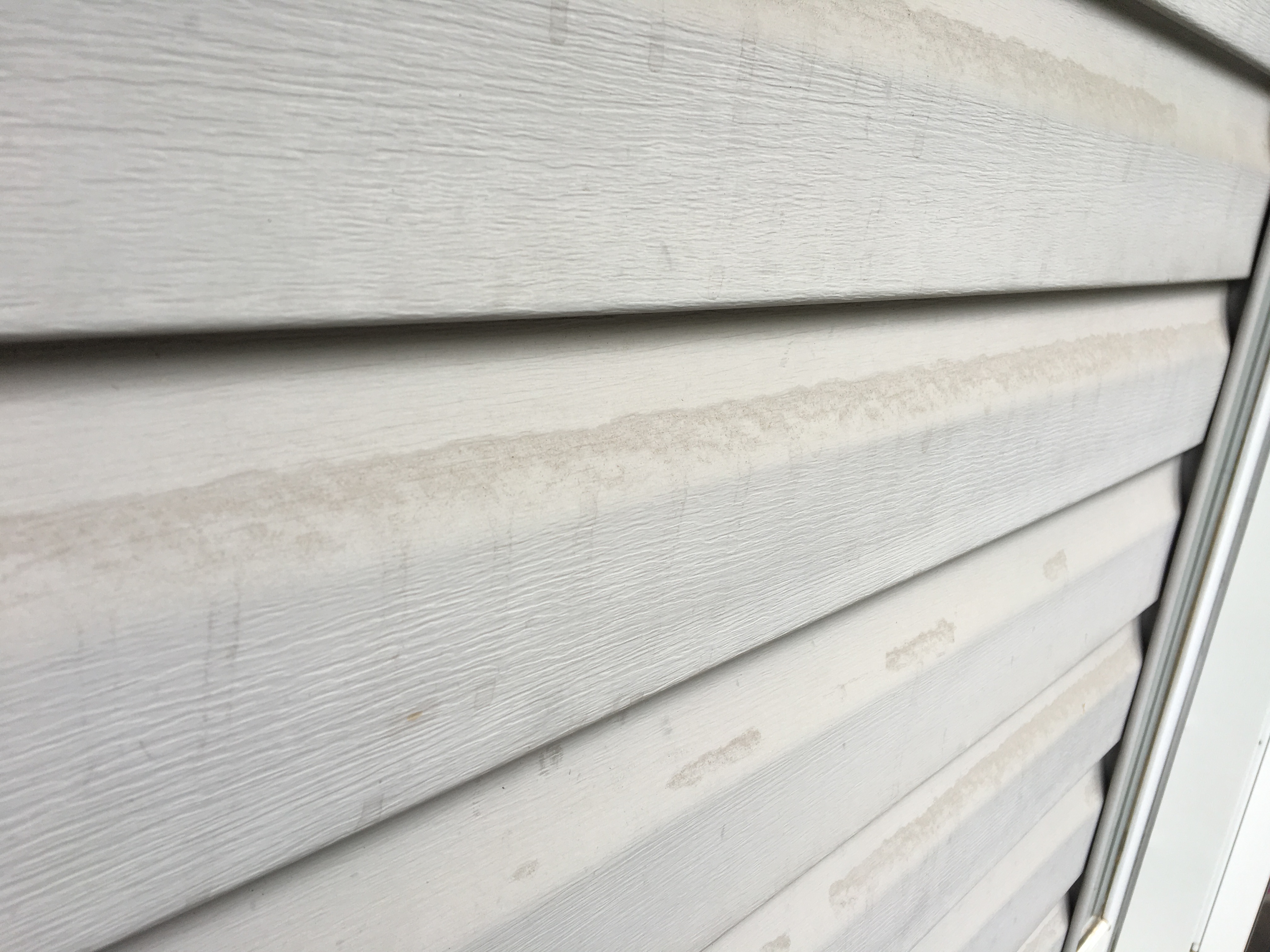

I went there a couple months ago to test a few products to get the wallpaper glue off the houses and windows. I found that Purple Power was the golden ticket.
The cornstarch glue wasn’t really easy to see, but you could feel the gritty clear film on all the surfaces and see it on the bottom edges of all the window glass. It covered the algae and north sides of the houses so well that house wash mix didn’t even change the algae’s color.

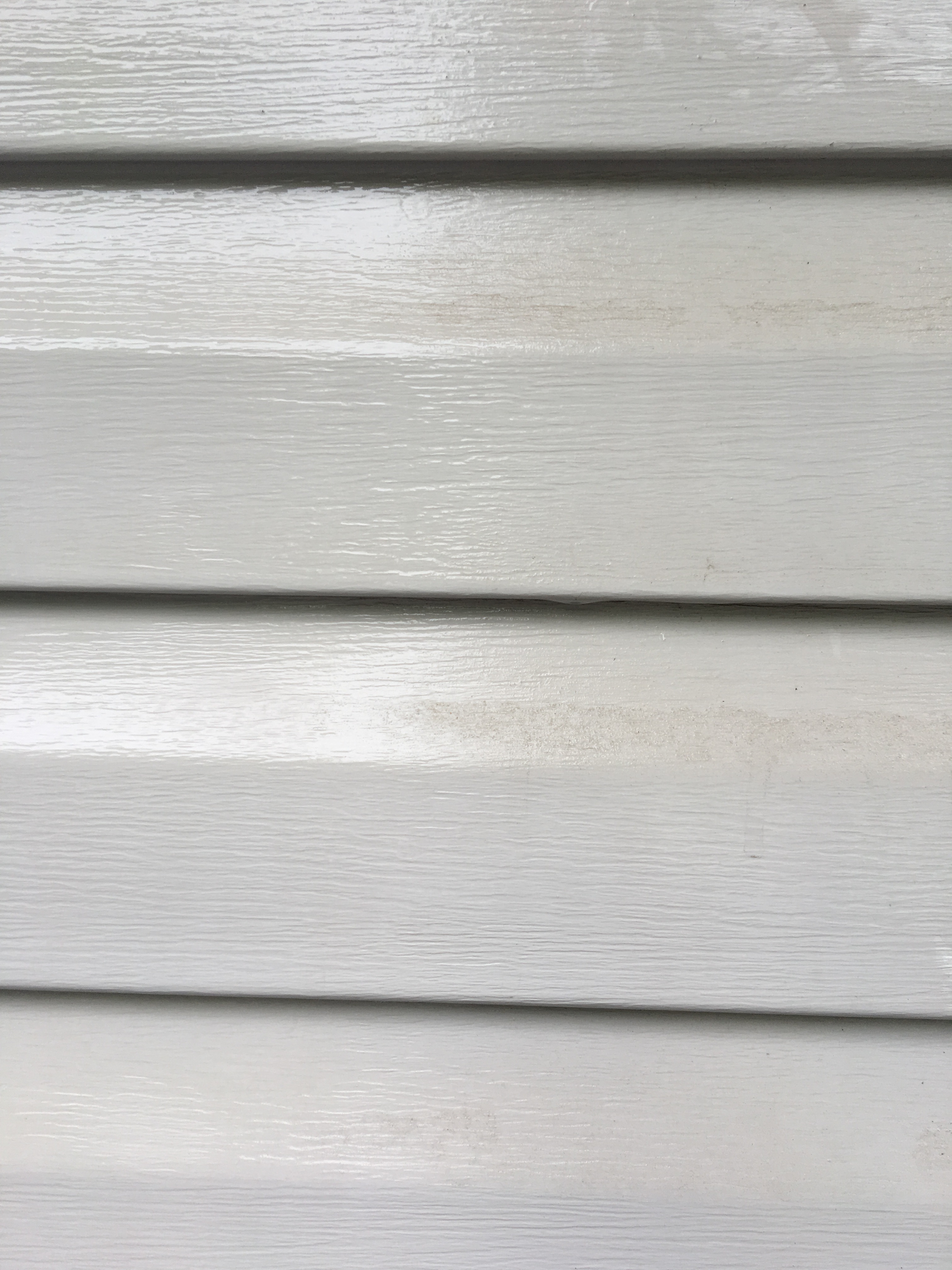

Anyway, if anyone runs into houses covered with cornstarch glue Purple Power downstreamed twice followed by HW mix is the ticket. Weird stuff, but who knows… if you run into it now you can say you know how to clean it.
