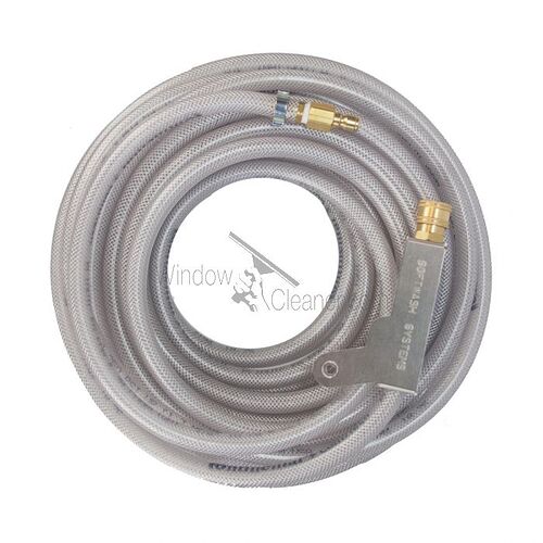

Has anyone used this kit to utilize a water fed pole with the pw? Put a j rod or m5 twist nozzle at the end and could reach super high doubling up with a shooter tip…
https://windowcleaner.com/pro-softwash-water-fed-pole-gun-adapter
I can’t imagine many people wanting to hold a cumbersome water fed pole to rinse a 5,6 or 7 story building/structure with this attachment on the end. I like the idea though just not practical.
You’d have to run the very heavy pressure hose up to it, the pole plumbing can’t handle that kind of pressure…unless you plan to 12v the sucker.

I can see the possible usefulness of this attachment, for maybe 3-4 story stucco work where a 12v would struggle without a little extra reach.
I love WCR and support them every chance I get. But IMO this is overpriced. They didn’t even use stainless fittings, from what I see in the pics. Polybraid hose is a pain to work with, as well. I prefer flexzilla or other hybrid hose options.
I think they should just sell the bracket attachment along with a couple of those fancy ear-clamps, and let people source their own preferred fittings and hose.
I want to see the video where he hooks it up to a pressure washer
