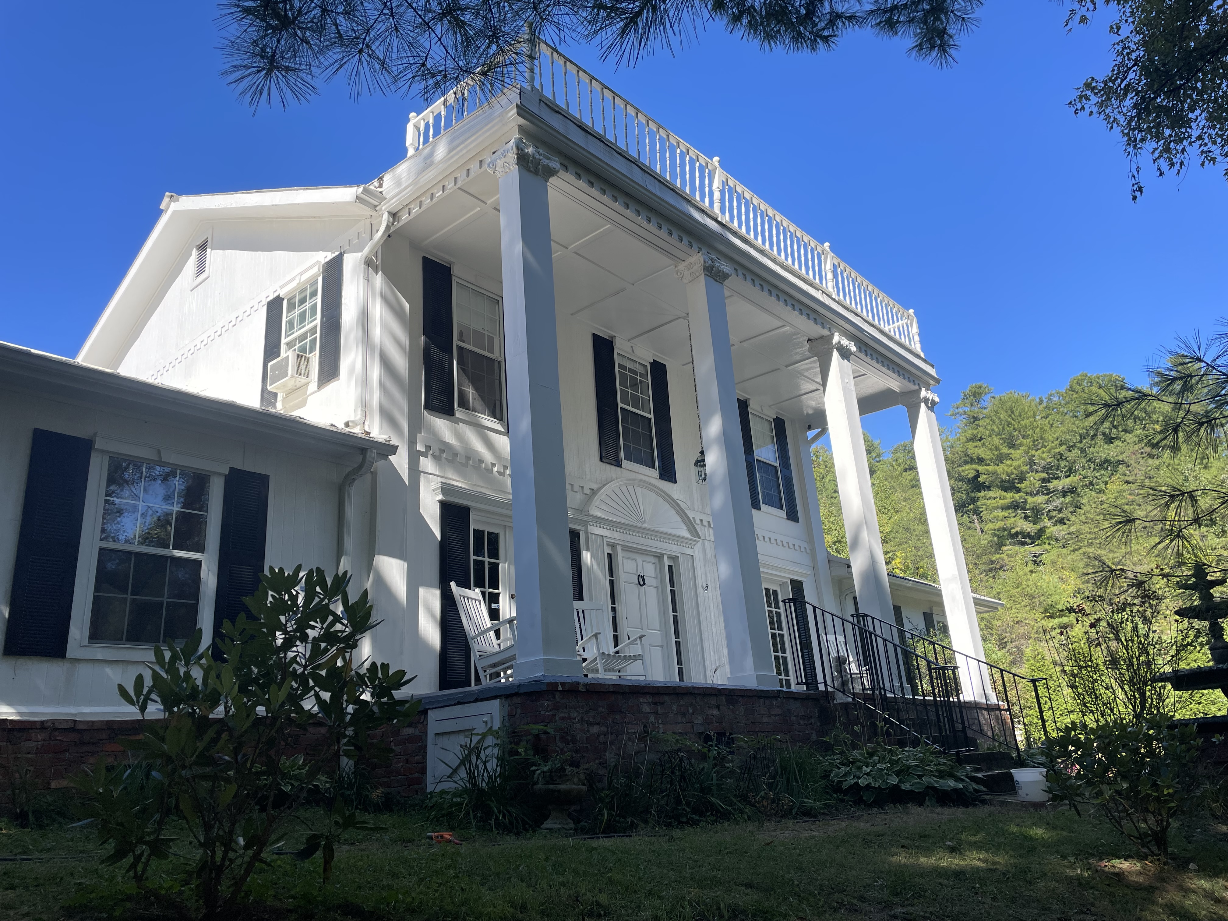

I used my waterboss today, just couldn’t help it. Perfect job for it around the delicate plaster work here when you need low pressure and the M5DS slaps a little too hard.
