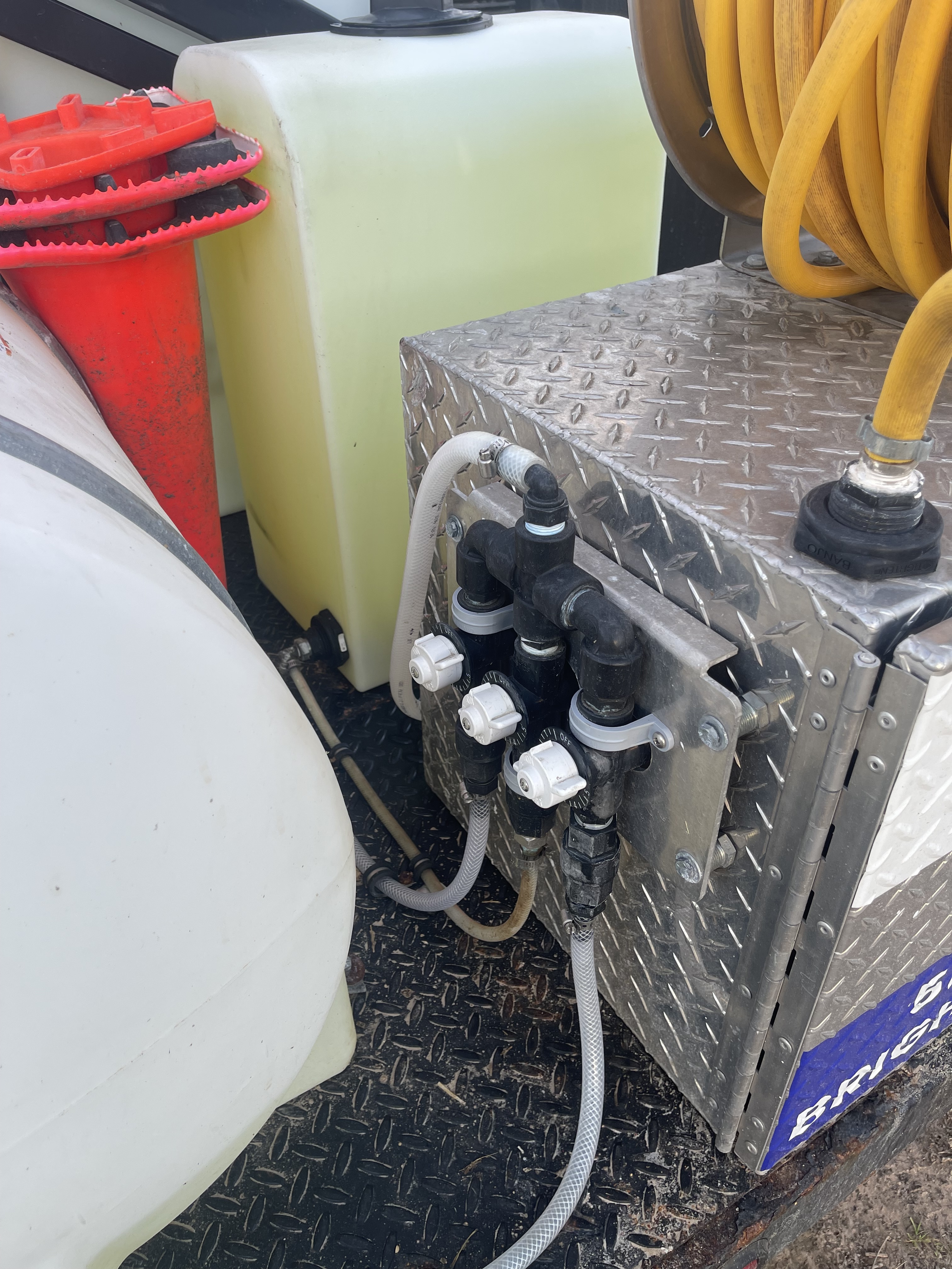

Water mixing into soap tank
Hoping someone smart can tell me why water is draining into my soap tank. Seems to happen when I turn the soap valve higher than 2. What am I doing wrong?
bad check valve on your soap line
Yup, mine did the same thing twice, ruined 20 gallons of SH. Those check valves fail just looking at them, cheap crap.
Thank you both, gentlemen,
Check valve…
