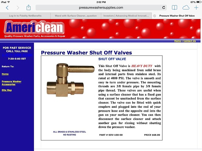

Does anyone know where I can find a “Y” type connection for the pressure side of my surface cleaner? I need to attach a wand and switch between them to get the corners that the surface cleaner can’t reach. Thank you!
What about a quick connect shut off valve?
http://www.powerwash.com/parts-and-accessories/switches-and-valves/plated-steel-ball-valve-7000-psi-3326.html
This is what I use. I switch between my surface cleaner and wand very easily.

Here is the ball valve that we use.
3/8" FPT Heavy Duty Ball Valve - BALL VALVES HIGH PRESSURE / LOW PRESSURE
This brass nickel plated ball valve is a “must have” for any pressure washing professional. By installing this at the end of your high pressure line you can now switch from one gun to another or from your gun to a surface cleaner WITHOUT shutting down your pressure washer. This time saver features an aluminum ergonomic handle for easy operation and Teflon seals. 3050 psi @ 300 degrees. 4000 psi @ 180 degrees.

Thank you! This is exactly what I was looking for.
