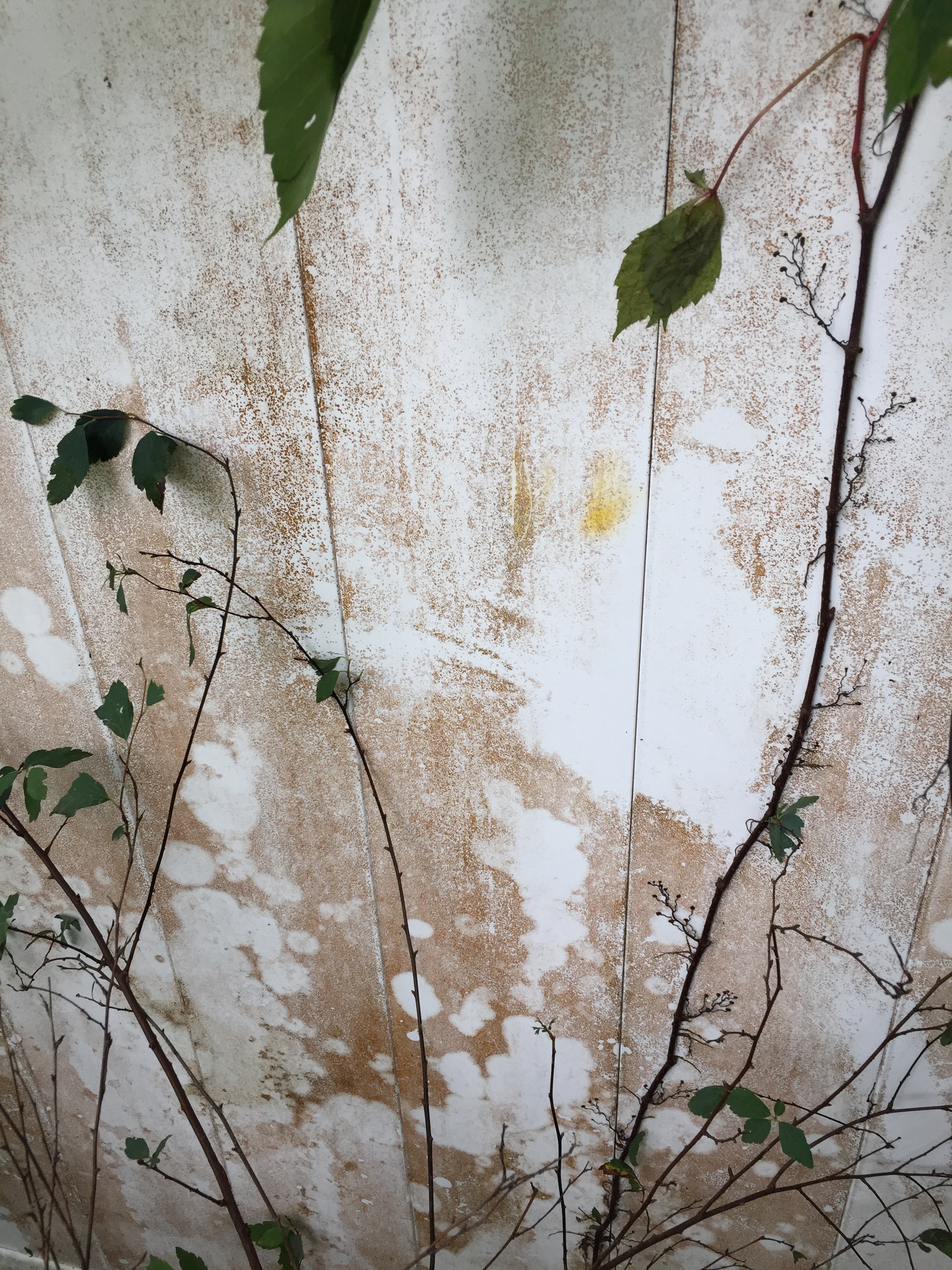

Hey guys I was washing a house today, and the homeowner asked me if I could clean his vinyl Fence as well. I ran across this stain on it, and wanted to know what it was and how I could clean it. Thank you guys very much
Hard to tell what it is but oxalic acid.may do the trick.
just a stage of mold, mildew hit with 6%-12.5% & rinse

i upped the dose of oxylic acid and didnt even budge it.

How did the fence cleaning end up? Did it require agitation beyond a pressure wash and chemistry? When you were done was the vinyl stained?

Looks like mold to me. I’d just use a mold killer and pressure wash it to clean it a bit first.

i honestly just used dollar store toilet bowl cleaner and a mr clean magic eraser mop and it took it right off
