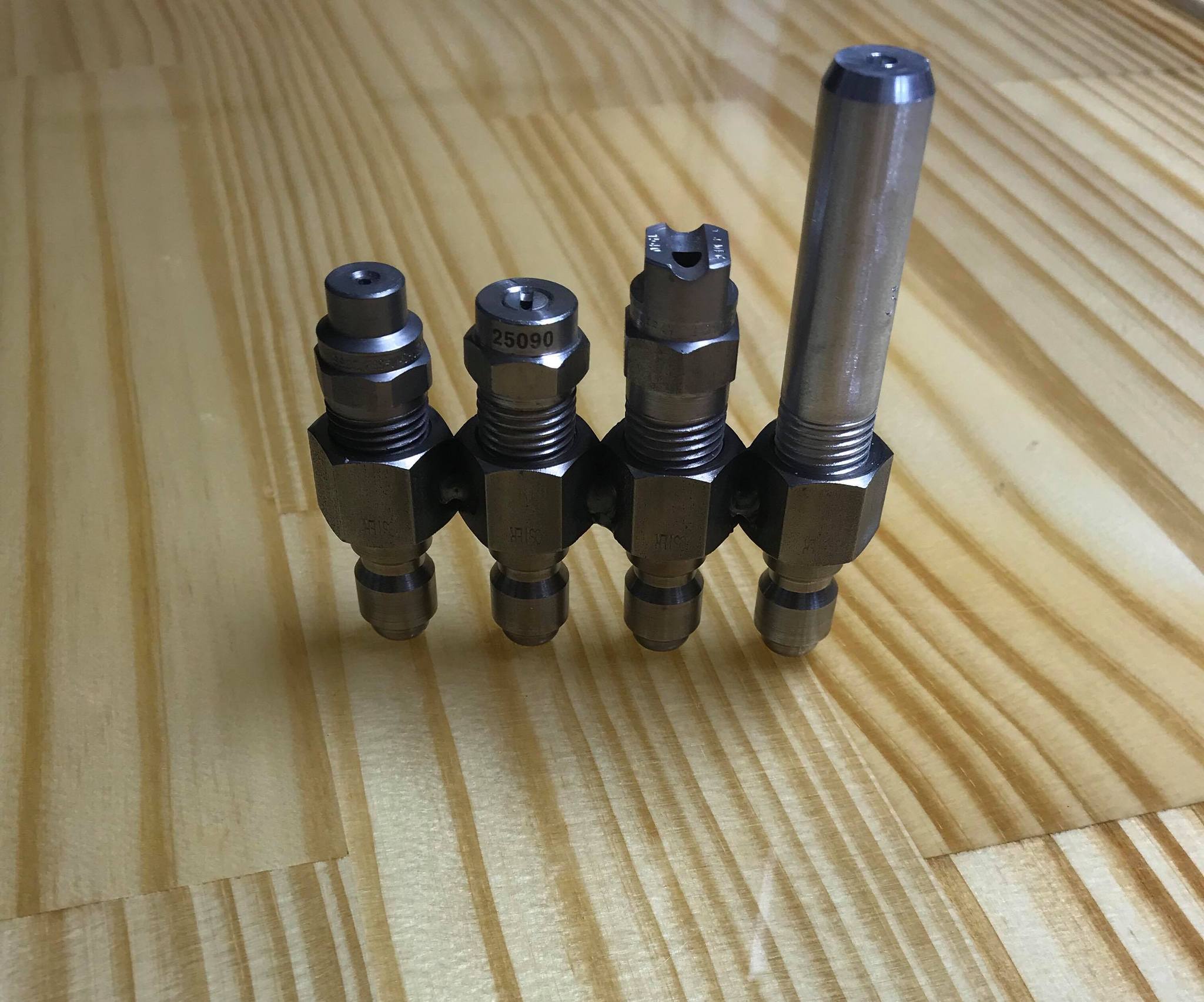

Use a shooter tip. Or make your own. Only need about 6 inches of straight tip. It’s all in the tips and volume of water
Ditto, shooter tip. A 4/4 is only going to reach so far though, the main reason why I upgraded last year.

You won’t get ripped off, a shooter tip will last you for many years. It’s just a straight piece of 6 inch pipe to straighten the stream out. The coloured tips you get with your pressure washer when you buy them are rubbish. You only need 3 tips including the shooter tips if your washing houses.

Here’s what a jrod looks like with the shooter tip.

I see what you’re saying. As an option, you can drill out your red tip with a drill press and make a sorta shooter tip.
@dcbrock ooo never thought of doing that, thanks i will test that out this week, red tip is useless anyway
Black soap tips come in different degree patterns. You may have a 25. A 40 or 65 will give you a wider pattern. You are using #4 orifice nozzles, giving you full psi of your machine. You rarely, if ever need that much pressure. Size 6-10 will be better for most applications. You will get a straighter stream with less mist with a zero degree nozzle with a larger orifice. You can find colored nozzles cheap on eBay if you have access.
You could drill a bigger hole in your red tip if you dont use it.
That’s a good point. If you drill out your 0004 nozzle to twice the size you would have about a size 10 orifice.
@Dantag that makes sense thank you so much yeah I think i might be able to to find bigger orifice colored tips would be easier than the Jrod with we have 0 of them here lol, worst comes to worst I can drill a hole like you guys suggested im sure I can find a lot of size 4 nozzles here and can easily get them so I can also mess it up and test with it thank you so much everyone!
