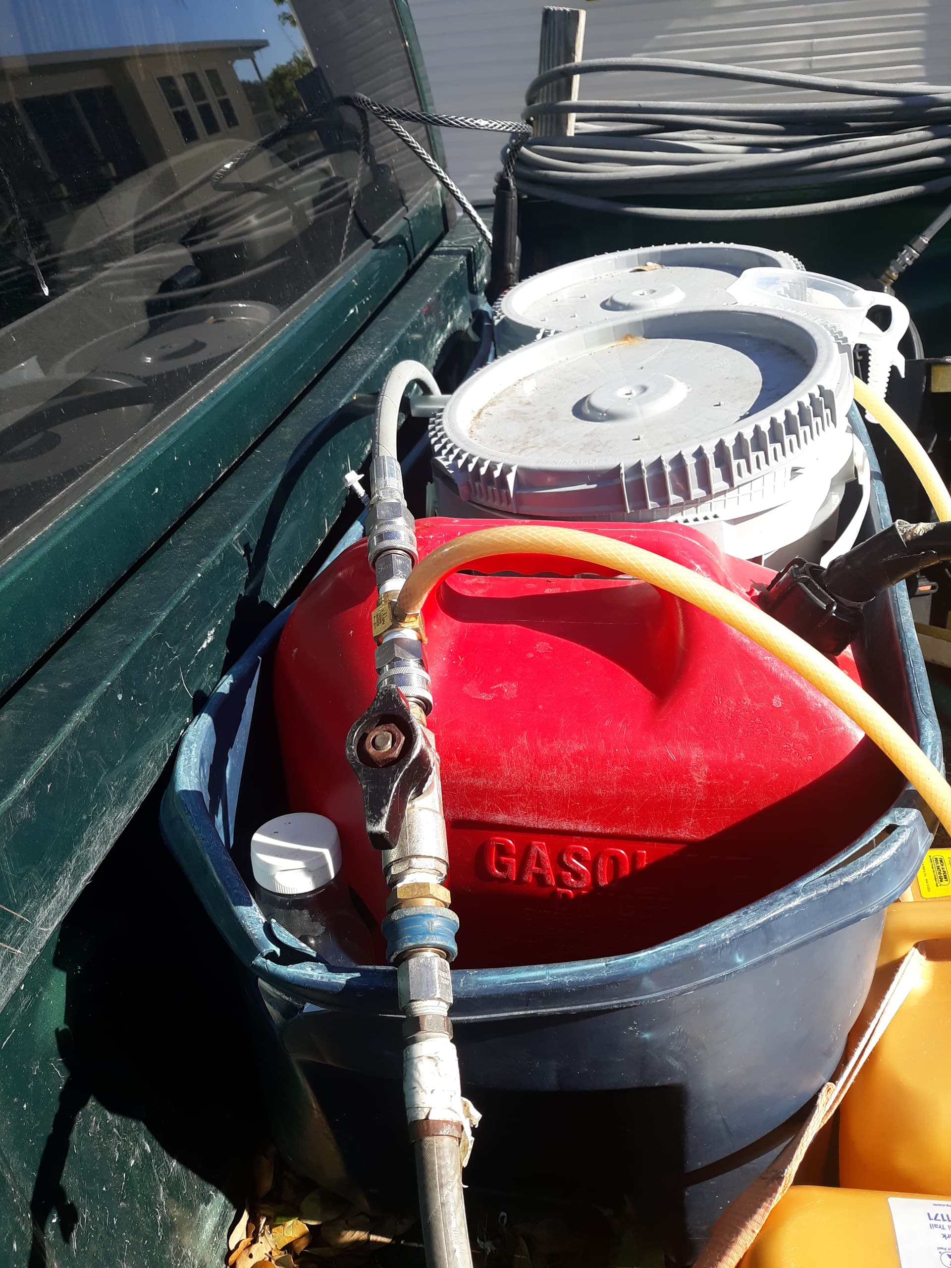

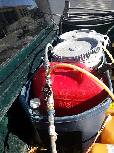

i put my ballvalve right off the unloader and unloader block. I dont have a auto or remote inj shutoff/on. I dont have my hoses run thru a reel either. So, when Im at the point if rinsing, I just close valve, remove injector and put it into fresh water bucket. ive still got some trailer rearrangements to make, I jusy havent done it
I like the thought of putting it right off the unloader once i build a proper setup with an unloader block. My injector is the next in line now. I have a 10ft whip from unloader to my chem injector and chem storage. I used to plumb the injector right off the unloader😔. I read something here that made me realize the injector could back leach and ruin other things

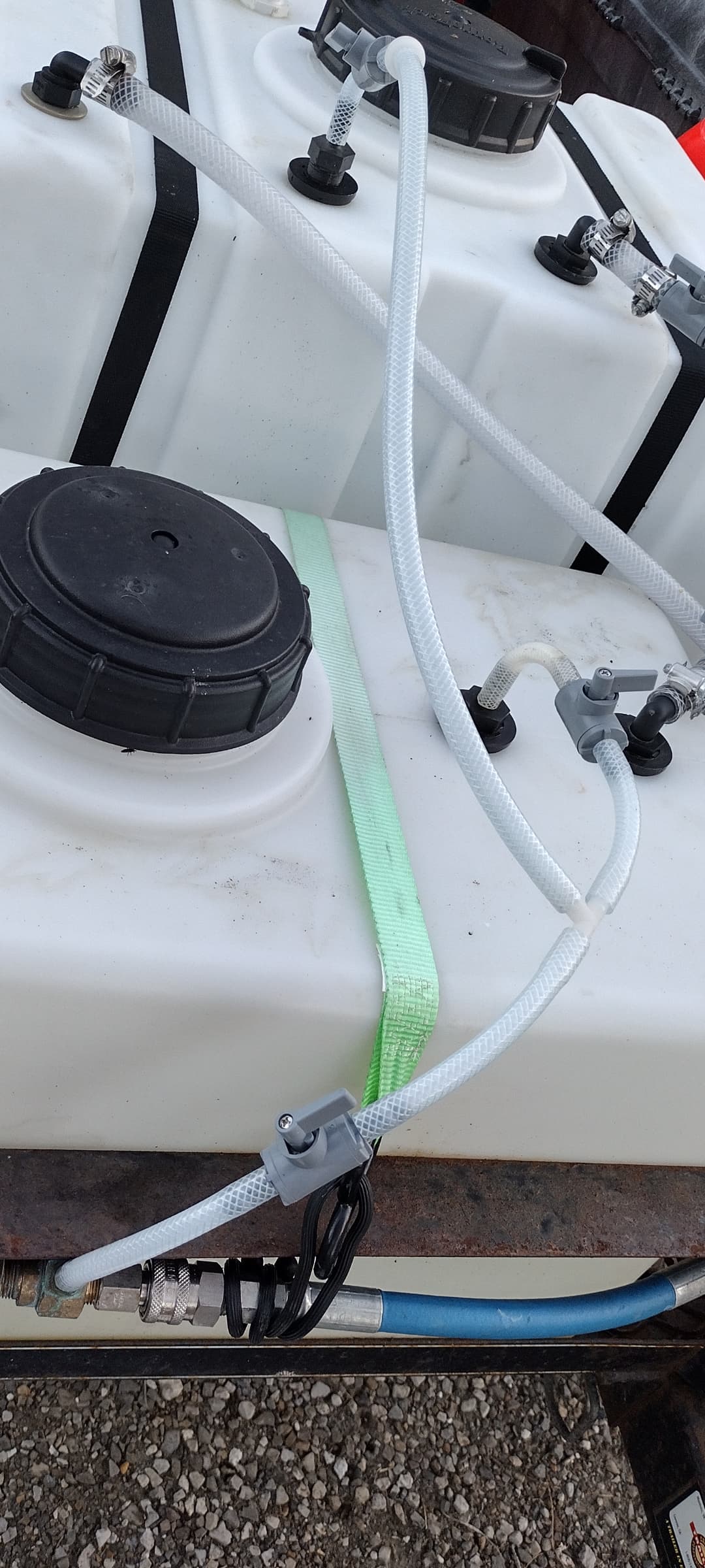

Soap tank is closest to the camera, injector is at the bottom left corner. A 1/4 inch in-line check valve keeps suds from siphoning back into the buffer tank (it will happen!). I really like this set up, even though I have to walk back to the trailer. I can adjust my DS mix by adjusting the knobs on the fly. I run 3 ball valves but the first one by the injector really isn’t necessary. When rinsing with soap nozzles, my injector is drawing water from the buffer tank. Shortest, straightest route to the soap tank seems to provide the hottest mix.
One three way valve would be a lot quicker and easier.
I am sure you hit the nail on the head as usual, but I really like the control I have with this set up. I literally turn both valves at the same time (one in each hand). Both valves wide open for vinyl. Water valve closed / soap wide open for brick, EIFS, etc… Soap valve closed / water wide open for rinsing. It doesn’t seem like I could get that kind of control with a single 3 way valve but I’m all ears. It’s a huge step up from where I started; batch mixing out of a 5 gallon bucket. I caught a glimpse of one of your remote setup builds from one of your videos but there were no model numbers for some of the parts. I’d rather build one of those but I don’t mind the exercise in the meantime.

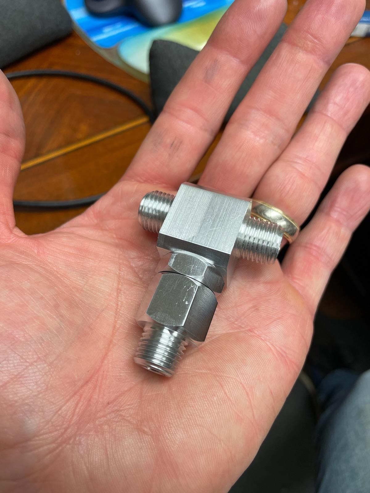

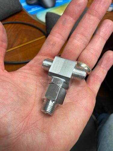

This is where my new Titanium injector will come in. I should have a few in hand soon to test!
You serious, Clark?
It’s already gone through multiple revisions since this pic was taken so I’ll show you this one.
Lots of new products coming to the PW/SW industry. I spent 7 months working on a new 2 step gun that’s about to hit soon. It’s 4 times lighter than what’s currently out there :grin:
