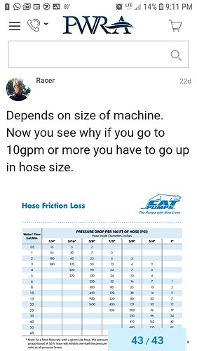

Anyone got that psi loss chart @Racer had handy ?

I wouldn’t go higher than 2500psi on any concrete. That being said, I still wouldn’t buy a machine that’s less than 3000psi due to the length of hose being used etc.
I’m not saying to wash it @3500 psi. But if he’s gonna go with only a 5.5 @ 2500 running 200 ft what’s that gonna be ,like 2100 psi @ 5.5. Now if hes at a 5.5 @3500 then he will loose around 400 psi then nozzle it to get around 25,2600 psi .right? @anon37135677. Need more psi for a tuff turbo nozzle job then just get the 5.5 turbo nozzle.
Correctamundo. I figure he’ll be doing well to get 1900-2000psi. Most machines don’t put out exactly what they’re rated for.
