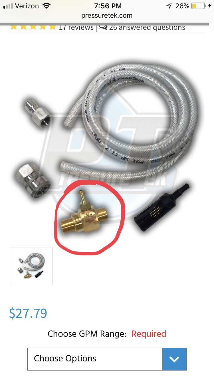

@sgb To be clear, you mean get several of these?
You don’t need the whole kit. Buy one kit and then buy 3 or 4 replacement injectors (the small brass part with the hose barb). Then just swap them out as they go bad. Some have terrible luck with injectors. I have great luck with them. In fact, the original that came with my machine still pulls soap. I rinse my injector after every job. Takes 5 minutes.
Yes yes. What he said. The injector is this thing. That’s what you need multiple of. Think about it for a second. You make money introducing bleach into your water. The only way to get that bleach in your water is the injector. If that thing messes up and I promise you it will and you don’t have a spare or three you will be very upset. Not being able to finish a job for a $15 part would not be fun.
