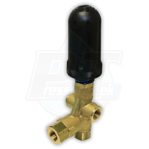

The one posted above is a high flow and good for like 21 gpm and is why it costs as much as it does. I have a Pulsar 4 on my 6.8 gpm since last season and has worked flawlessly. It’s good for up to 10.5 gpm. I have no idea why the picture is so big.
Great thanks. Do you know if it has a stainless steel spring?
It has stainless steel valves so I imagine is has stainless springs. Even if it doesn’t it’s still going to last for multiple years since the unloader is before your chemical injector and no SH runs through it.
Thanks! @marinegrunt

Post a picture of your old unloader and where it was installed on the pump. If it’s just NPT threads you should have no problem with the new unloader. Some cheaper pumps make you use their unloader specific to the pump. Going forward instead of mounting the unloader right to the pump get an unloader block and whip line. Mount the unloader block to your skid and then run the whip line from the pump (where the unloader was originally installed) to the unloader block. The unloader then screws into the block.
Most of those ports are just capped off so you can easily get to the valves.
