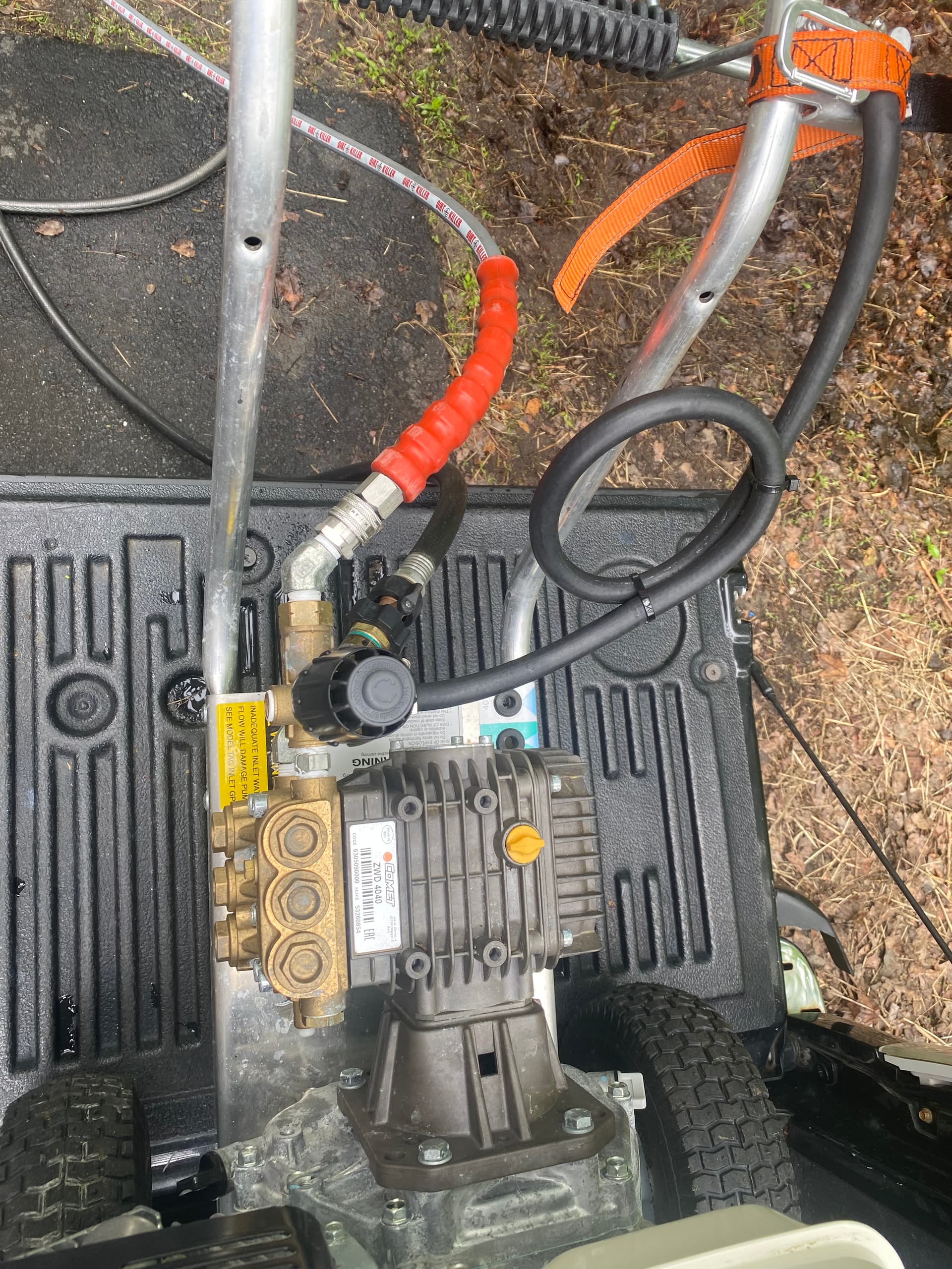

Trying to set the unloader. 4gpm 4000psi. Honda gx390. Using the green tip, gun on, started engine throttled about 75%, no water exiting bypass hose, turned the knob all the way down and all the way up still nothing, can’t get the trickle. Do I need to pop the knob off and tweek the nuts around the spring?
post a picture from a different angle
Why did you throttle it down?
Not sure, is it ok to run full throttle? Is it anything like flooring the gas pedal in a vehicle?
It’s supposed to be left on full and leave it alone. The engine has a governor that prevents engine damage.
Good to know, I’ll try setting at full throttle, thank you
I always start up and shut off my engine around 1/3 throttle or so… but it runs wide open while working.
