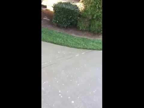

I’m not sure it’s etched either I just think you haven’t put enough pre treatment on, problem with a pump up sprayer is it doesn’t put out enough volume to saturate an area that big. SH works while it’s wet it’s probably flashed dried before it had had a chance to work. As far as the pressure goes 2500 is plenty for residential. There is virtually no way of knowing if you will etch 10 year old concrete until you’ve etched it, if that is etched with 2500 psi and it’s 10 years old I would be surprised, at that point there’s nothing you can or could have done.
See at the 22 second mark where I flash back to part I’ve already done and see how liberal it is and that had been a few minutes by then
Thanks Rick for sharing that, much appreciated. I think I will need to be more liberal with a post treat. I don’t have a 12v yet so I may need to get an x jet for the time being. How much time are you spending soaking the grass to prevent any damage from a post treatment?
