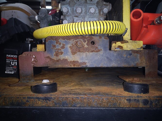

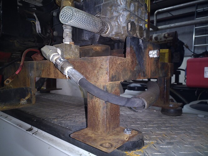

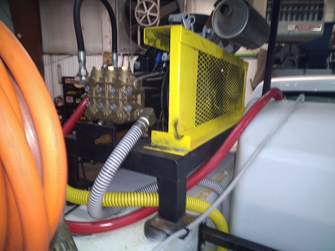

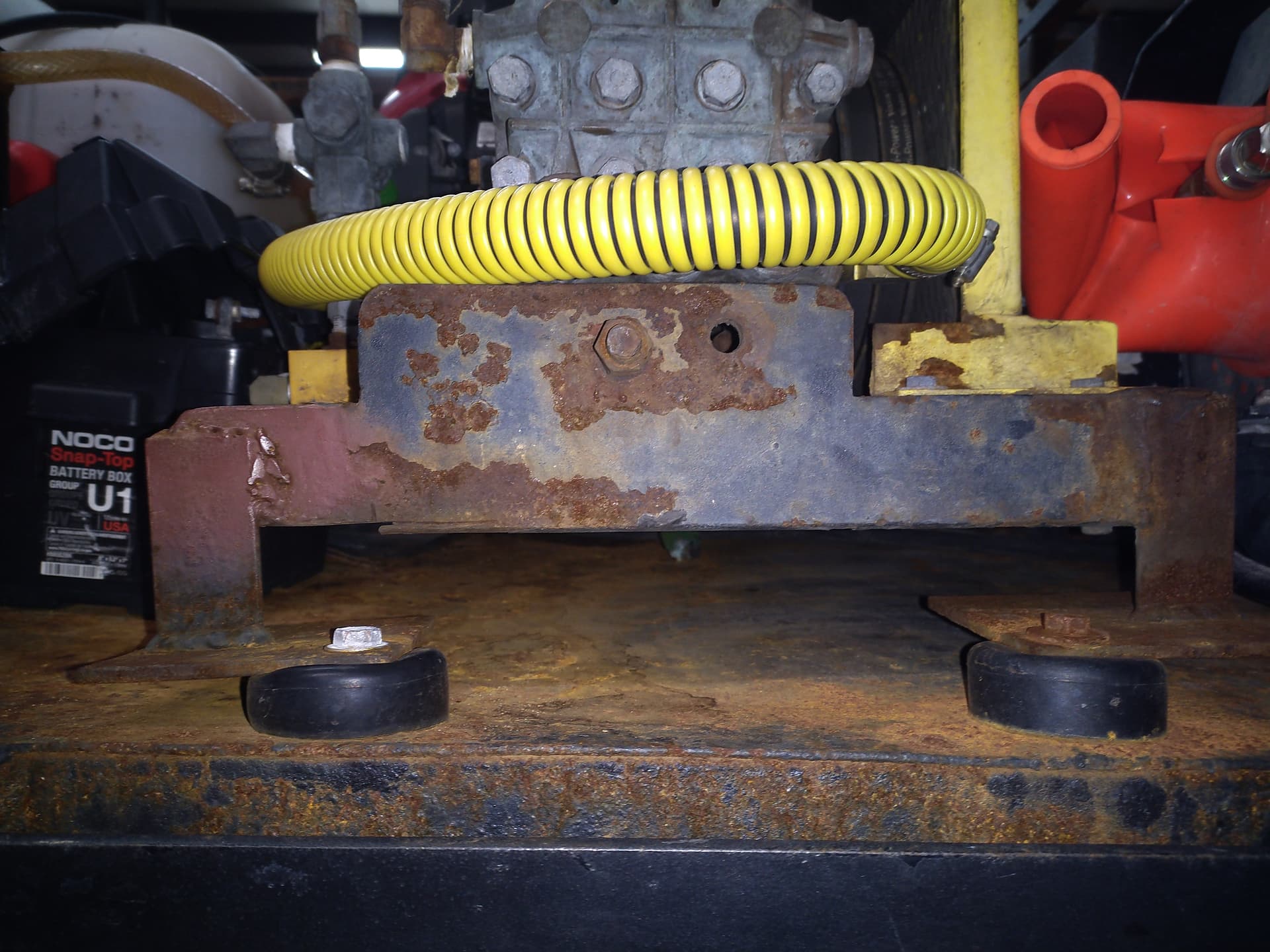

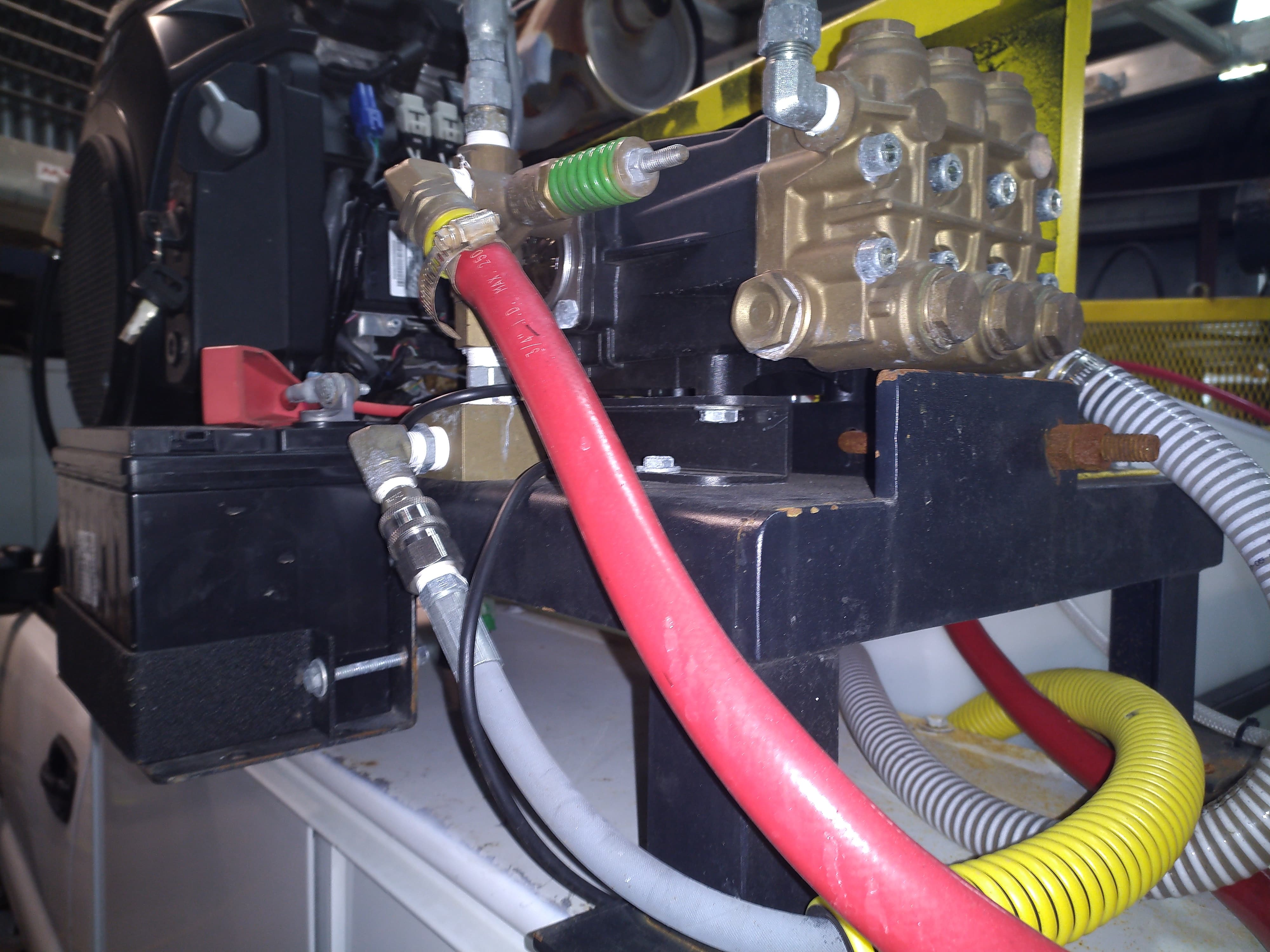

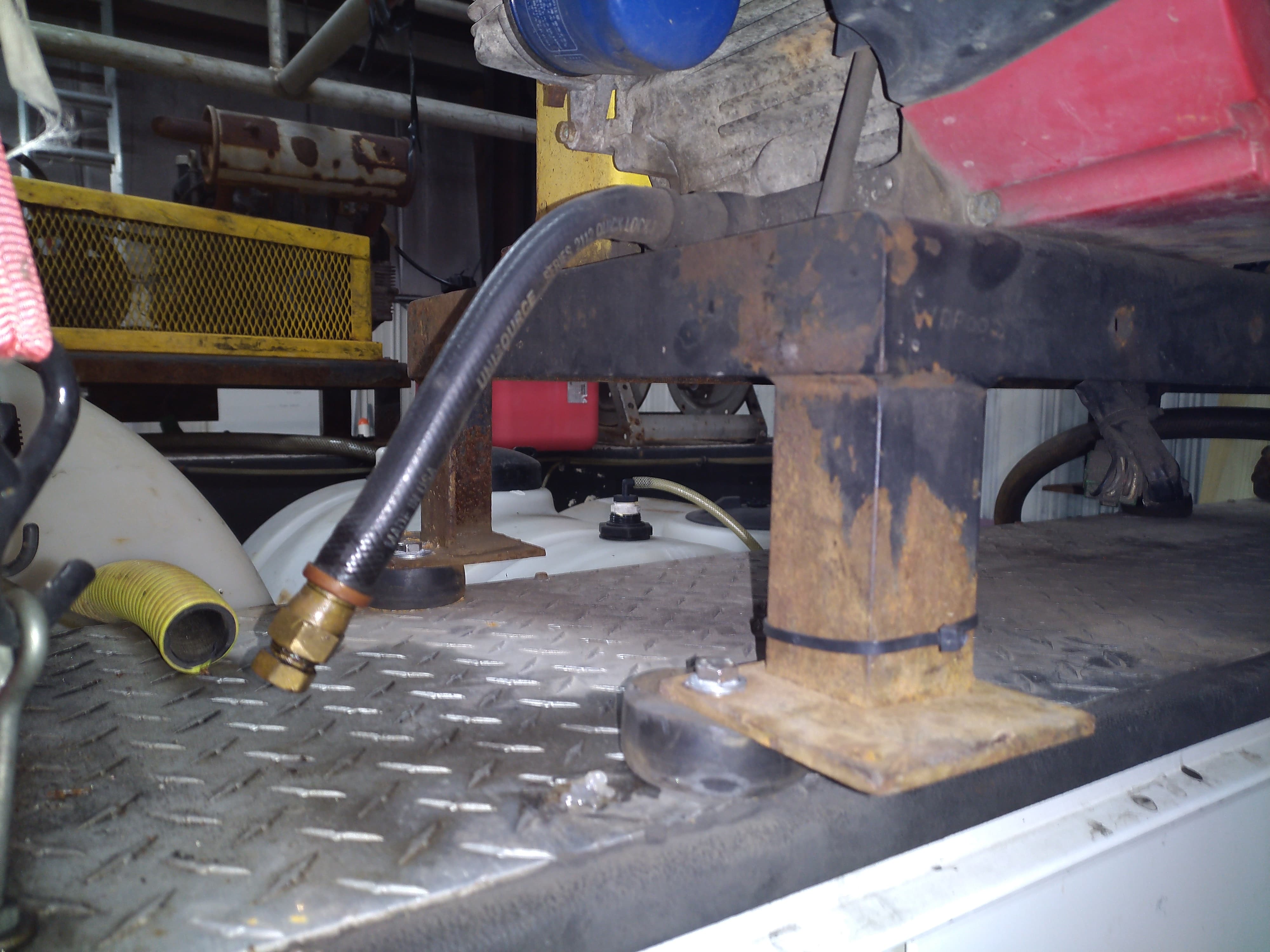

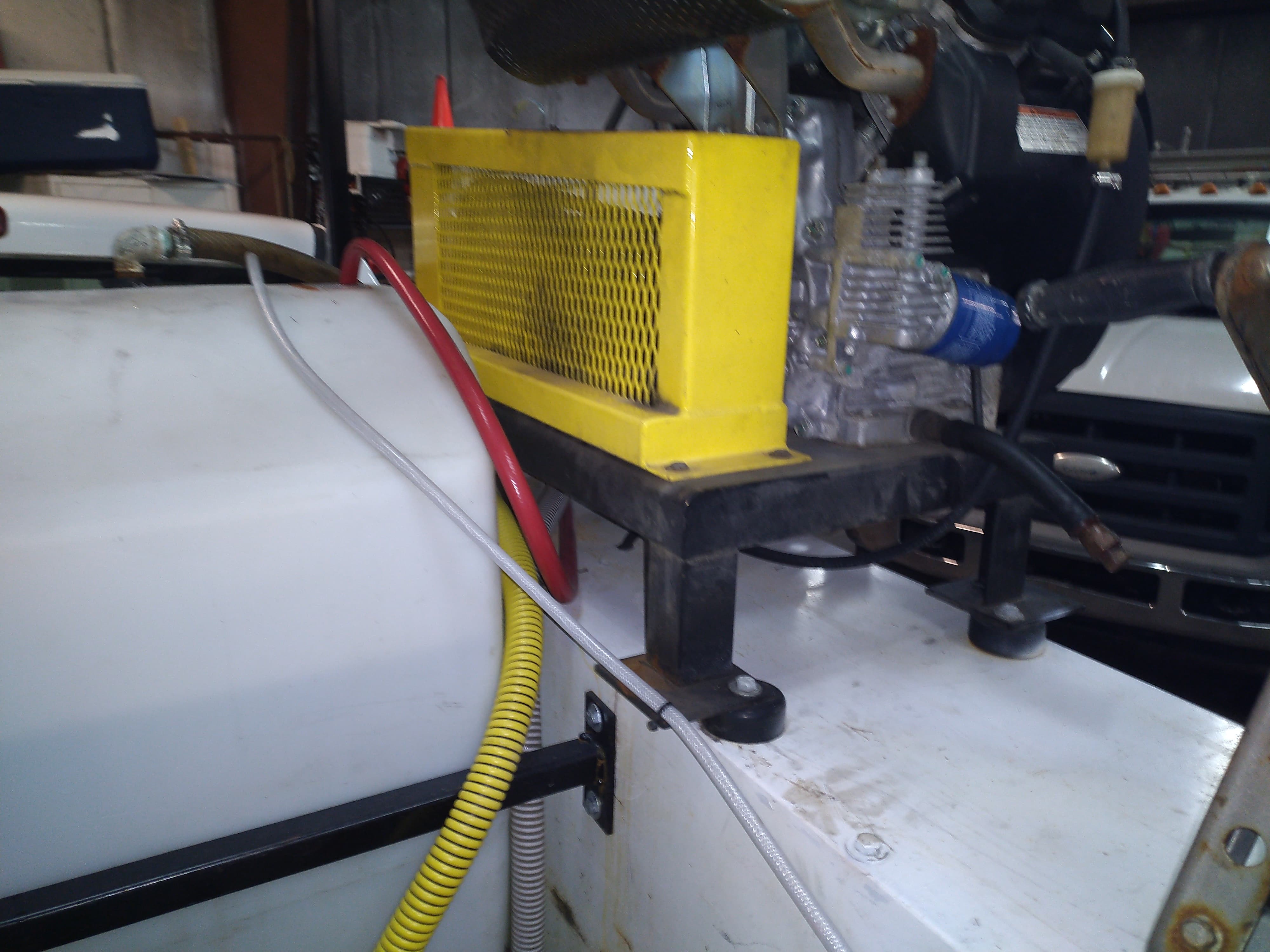

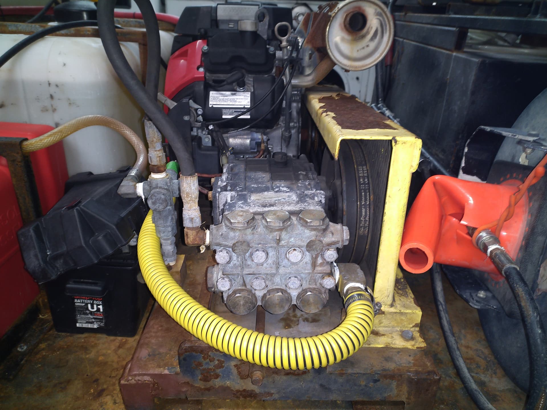

Will you send me a picture of your steel skid base plate? Going to fab my own out of 3/8 but would like an idea or two.
Here’s an idea for your skid. Super small footprint and low profile, and won’t rust
And some more info/pics further down in that thread:
Thank you sir.
