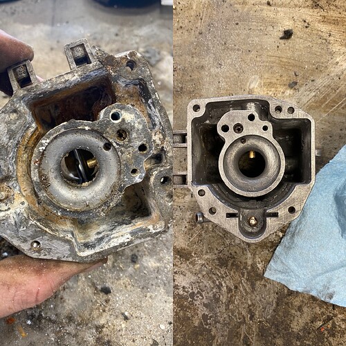

Todays progress:
I started to work at cleaning the carb……it was pretty dirty. Carb cleaner wasn’t really cutting it, so I actually let it soak in some rust rescue I had leftover from SESW. It cleaned it up nicely. I couldn’t find any small engine shop or box store that had gaskets for the carb. I may make some myself or just order them off a site I found that has part for the carb and engine for this model. Still haven’t decided yet.
I also grabbed a gear puller today and was able to get the pulley off the pump shaft, so that was a plus.
The boy helped get some rust off the wheel with a drill wire brush.
Overall, it was a successful day.
Can you get the engine numbers. I went down a very similar road. But i have a small engine shop that stocks stuff for these old motors. Pull the juts and tube out of that carb before you even think about putting it together.
