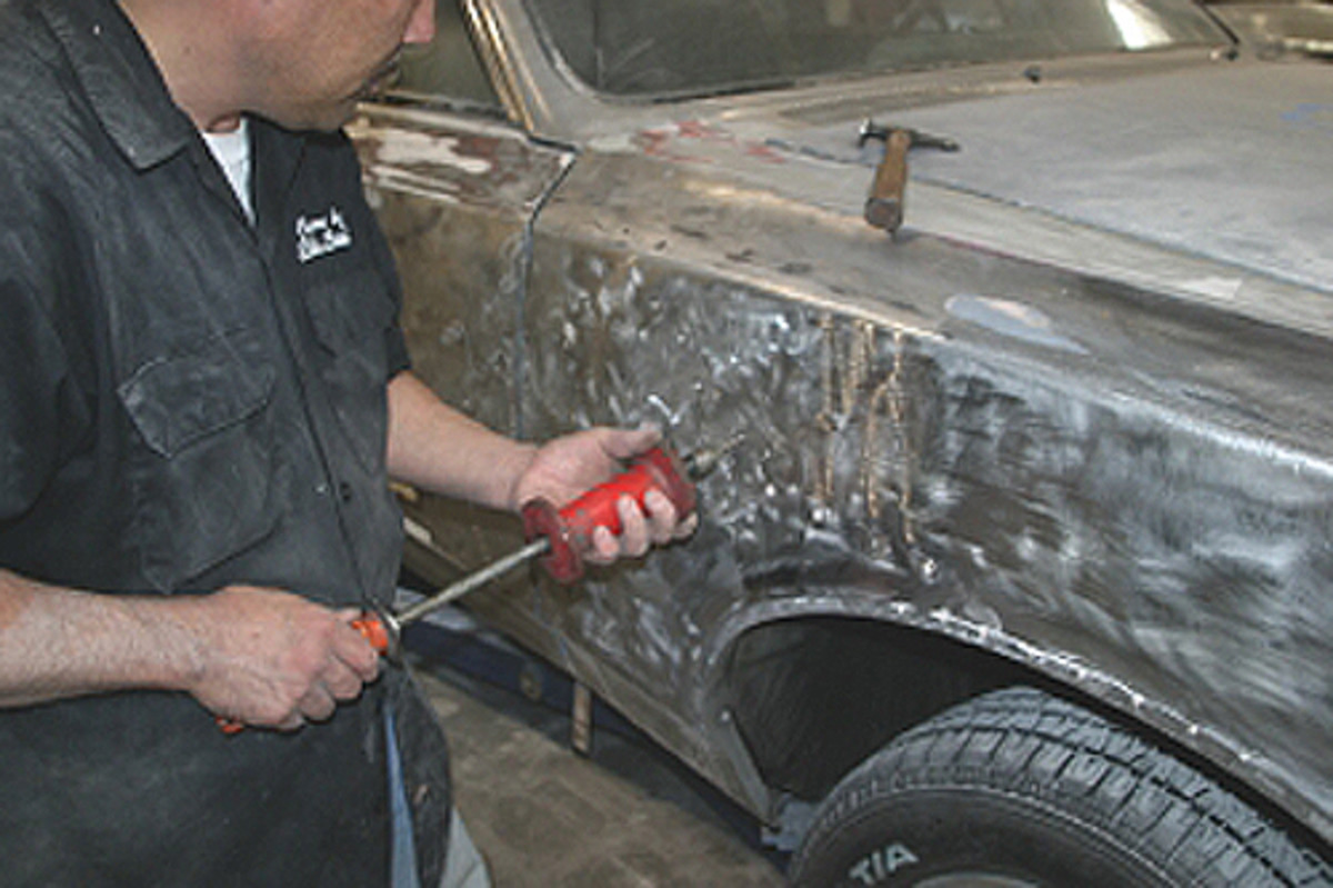

It’s not pretty, get the correct tool

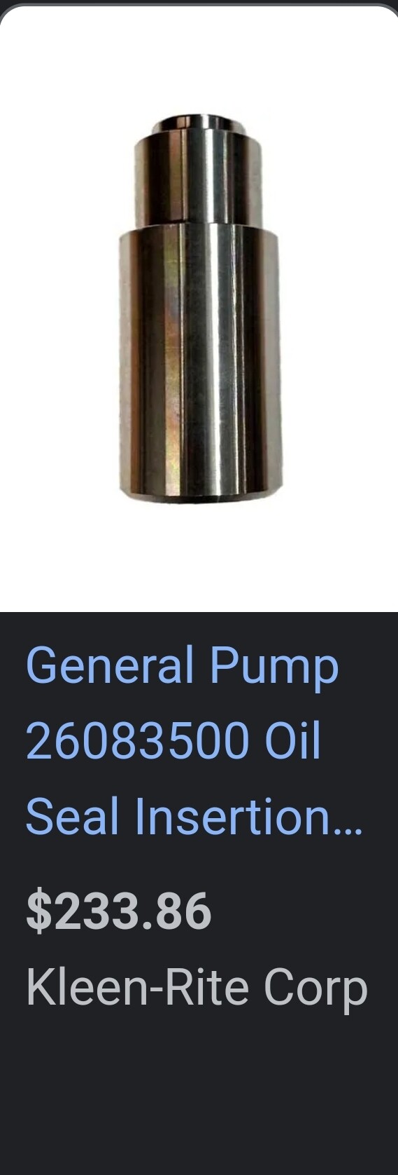

look here mi$ter$…lol
That is not the tool that I saw suggested. The one I saw was just over $50 lol but it was the removal tool and that looks like the insertion tool?
that may be the wrong part#, but it’s that high for the insertion tool, or more. which is why im asking. i was fishing.
