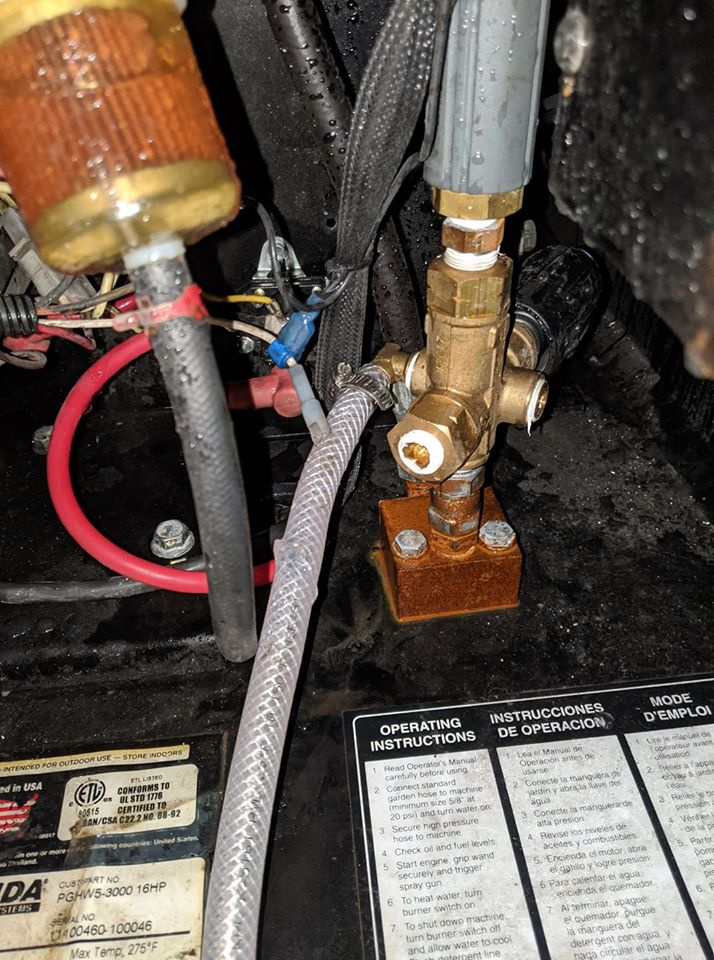

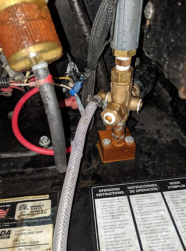

Can you upload a pic of it in your :raised_hand: also showing where it is connected in the same pic?

First time it blew was closer to the unloader, less than an inch away. The second time it blew about 1.5-2" away
Excuse me homie you’re running 1/4" bypass hose yowza
Can’t see that it’s bushed down from 3/8" but it definitely looks the same size as your fuel hose.
100% not 1/4"
probably 3/8", gotta go out there and measure it. I’m guessing 3/8" and not 5/8" as I sit here drinking my bourbon. Pretty positive it’s 3/8" and not 5/8"
I.d. though I see markings on it see if it says the size on it

Or put a tape on it. That particular hose would have 1/4" wall so see if it’s 1/2" outside diameter
checked my receipts and it is 100% 3/8"
How can I go to 5/8" or even 1/2" if only 3/8" fits on that barb on the unloader?
They do make a 3/8" od pvc hose that’s 1/4" id. To size up you’d just trade out the brass barb elbow
just put a tape measure to it. 1/2" outer with 3/8" inner
