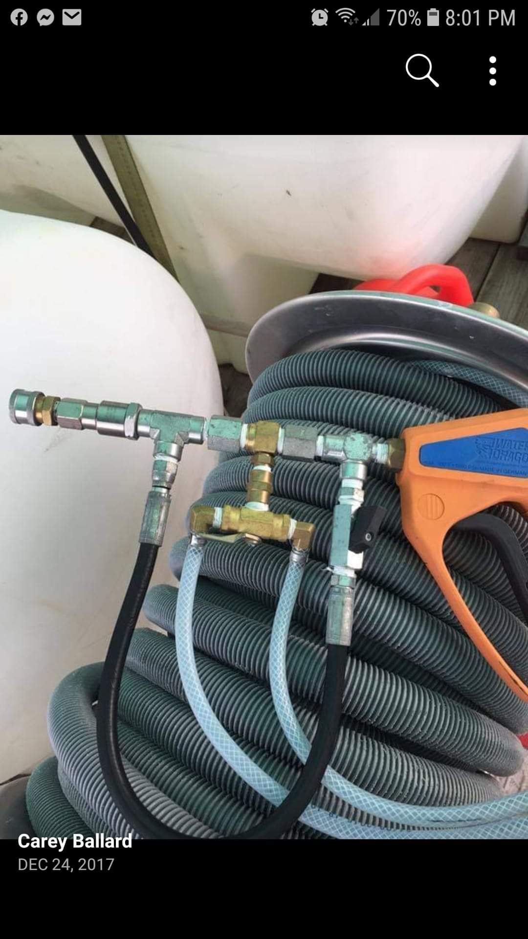

Seen this on facebook…not sure if any of you truck washers could benefit. Power wash store
Thanks @SurfaceTherapy !
@SurfaceTherapy I saw the same thing and wondered if that might be something these truck washers would be interested in. You beat me to sharing it with them. @Hotshot that sure is way cheaper than that $2k gun y’all been talking about.
@Hotshot somebody got them to post a picture
There’s gotta be more to it back at the PW. @pressureguy bought one from them ,cost him $1200 . So I’m assuming there not charging $900 more for 200’ of 1/4 " chem line , 100 of pressure line and 100’ of vac line do y’all?
Nice, thank you.
I’m confused, what does the black hose do? Is it just looped back on its self?
