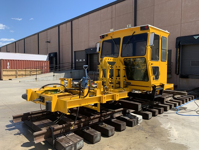

If that equipment is real greasy hot water will make your life easier. Maybe see if you can’t line up some more work that requires hot water and rent a unit for the day.

That’s going to be a no. With trucks you’re cleaning mostly road film and bugs. Heavy equipment like excavators have loads and loads of thick soft grease and a bit of the hard petrified stuff. Rail equipment is one step down from that. I wouldn’t touch either of the three without heat. On heavy equipment we’re upstreaming well North of 220 degrees. 95 percent soaping and 5 percent rinsing. Don’t give that work away, there’s good money in rail. I’m at $200 on it

I ended up cleaning it for $175. Took an hour and a little bit of degreaser. Cleaned up like new ! It was alittle but rusty but nothing you can do about that !
Looks good but I would have sat on it for two hours and billed him $400 Price out some rail equipment. They can swing your price don’t be scared they’ll balk at the price.

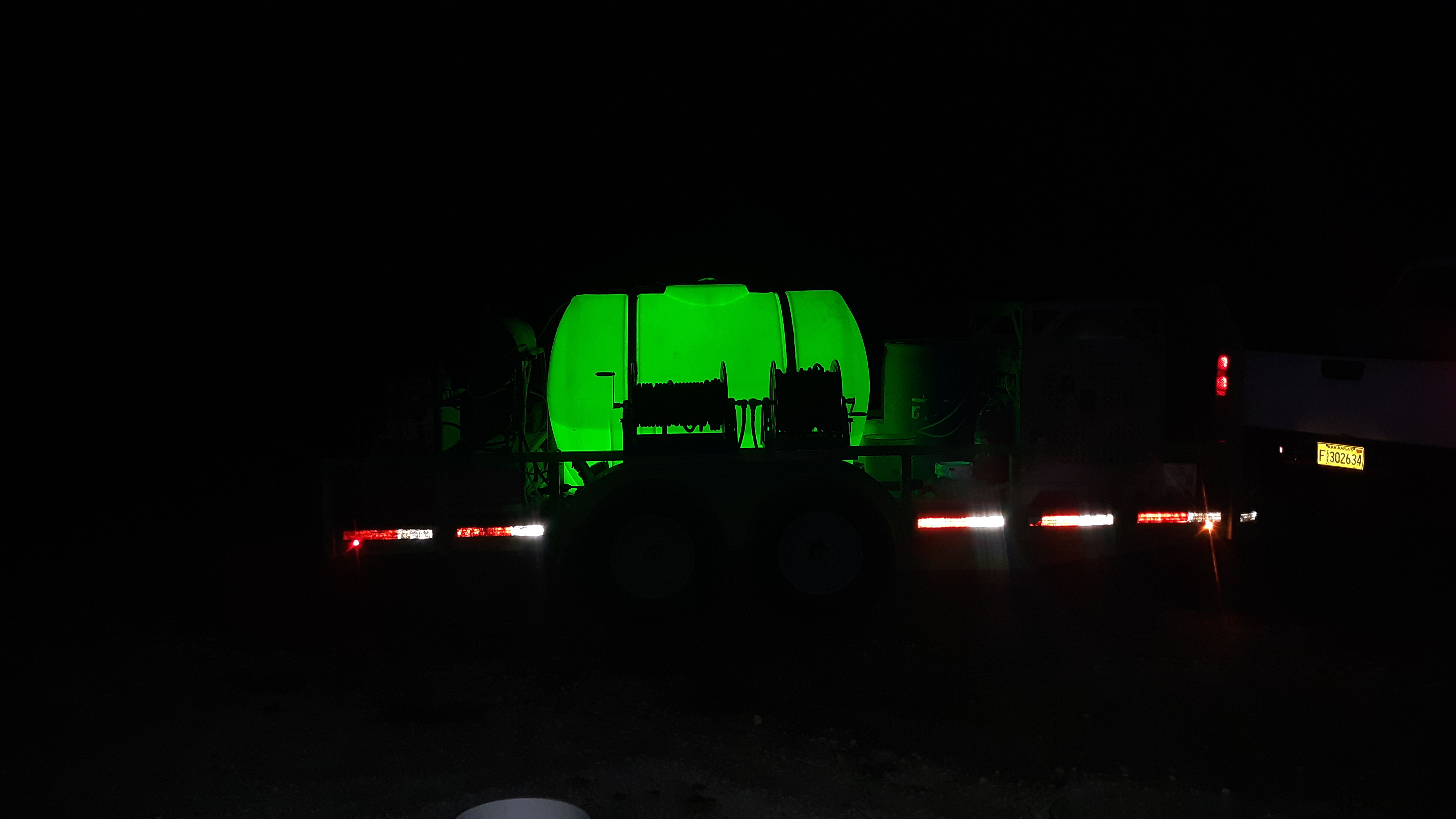

Night work just got brighter
Add some 12V LED water proof lights to the trailer edge (inside) for full on disco action.
LED Lights
Now that’s some serious algae! So why is that tank not sideways? Softer slosh using the front and back curves as ramps with less of your trailer length taken up.
