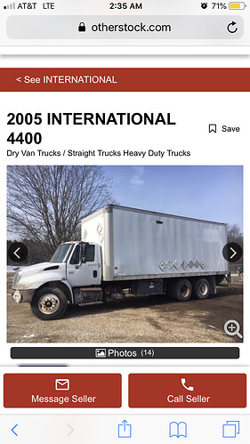

Pre-soak it as you do your cab. Then if it’s bugged up it gets a hot rinse through a 8’ lance. If you just have a couple of bugs you can just about get all of it cleaning from both sides. You’ll leave a 7" strip that you can’t hit with very much pressure but it’s not all noticable once it blends in.
What about the big trailer units, do you guys have to physically climb up to reach the roof or is that not part of the wash?
Something like this, the top part of the trailer (roof I guess) image
How do you get the top of something like this. Do yall climp up on a ladder @Hotshot
