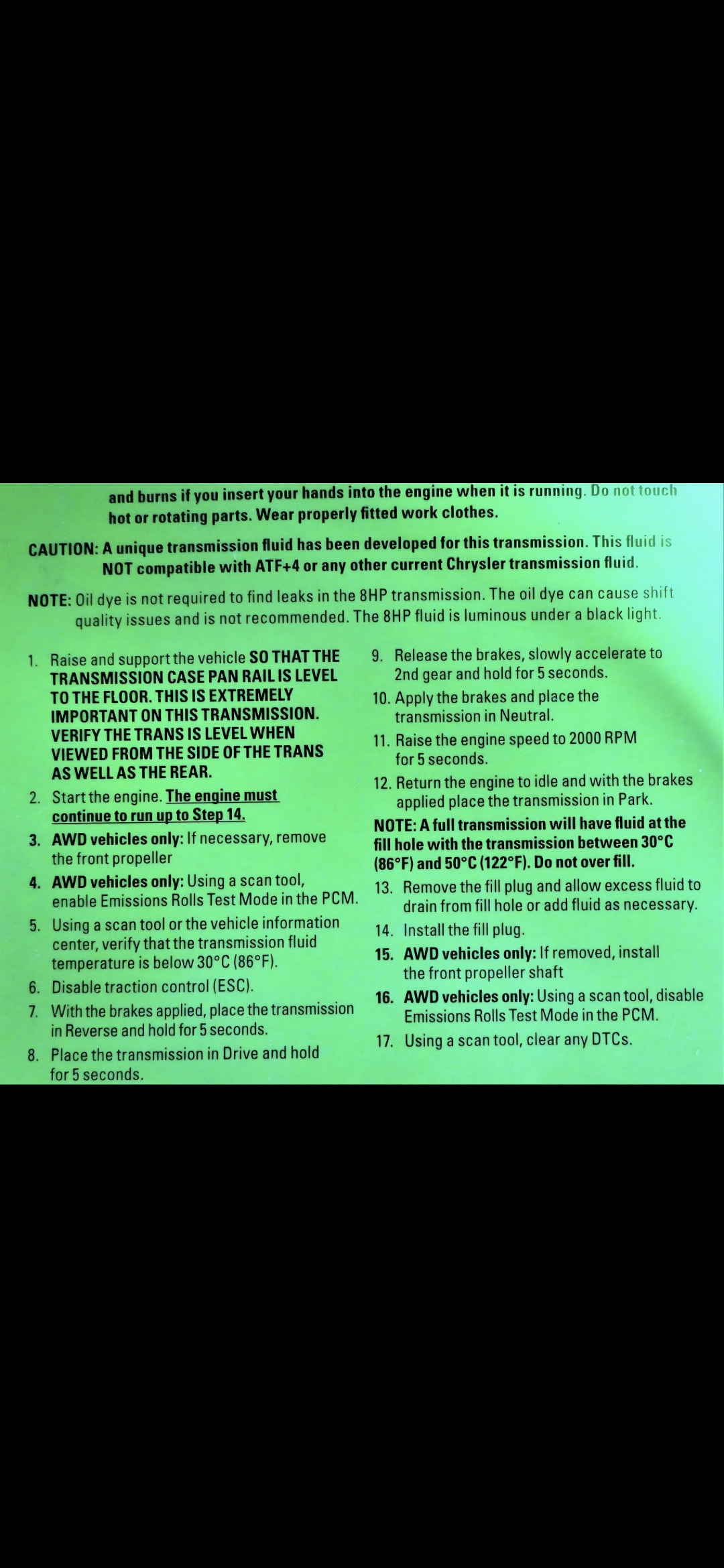

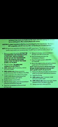

For changing the Trans fluid, oem filter is built into the pan, so best to buy aftermarket pan so you can change filter in the future, or add a pan with increased capacity. Dorman is reasonable. It’s cheaper and better. For fluid, don’t bother with the stupid overpriced mopar fluid. Valvoline maxlife is cheap, but thoroughly tested and approved for these transmissions. Its what I used on my first change and have ready for my second. Follow the directions below for the change procedure. Yes, follow all directions. This is to simply change the fluid and not flush the entire system. System flush is way more complex and those who want a full flush just drain and refill 3 times with running the vehicle for a bit inbetween each flush.
I have 12 years experience with these transmissions and have been a contributing member to several of the related vehicle enthusiast forums. Hope this helps, because you do need to properly maintain your 2500 now too. :slight_smile:
Edit: ignore the caution at the top. The valvoline fluid is an atf+4, but i don’t think when this trans was first developed that these fluids met specs or were tested to meet specs. That said, I can only confirm that the valvoline maxlife is the only atf+4 that I am confident that is compatible.
