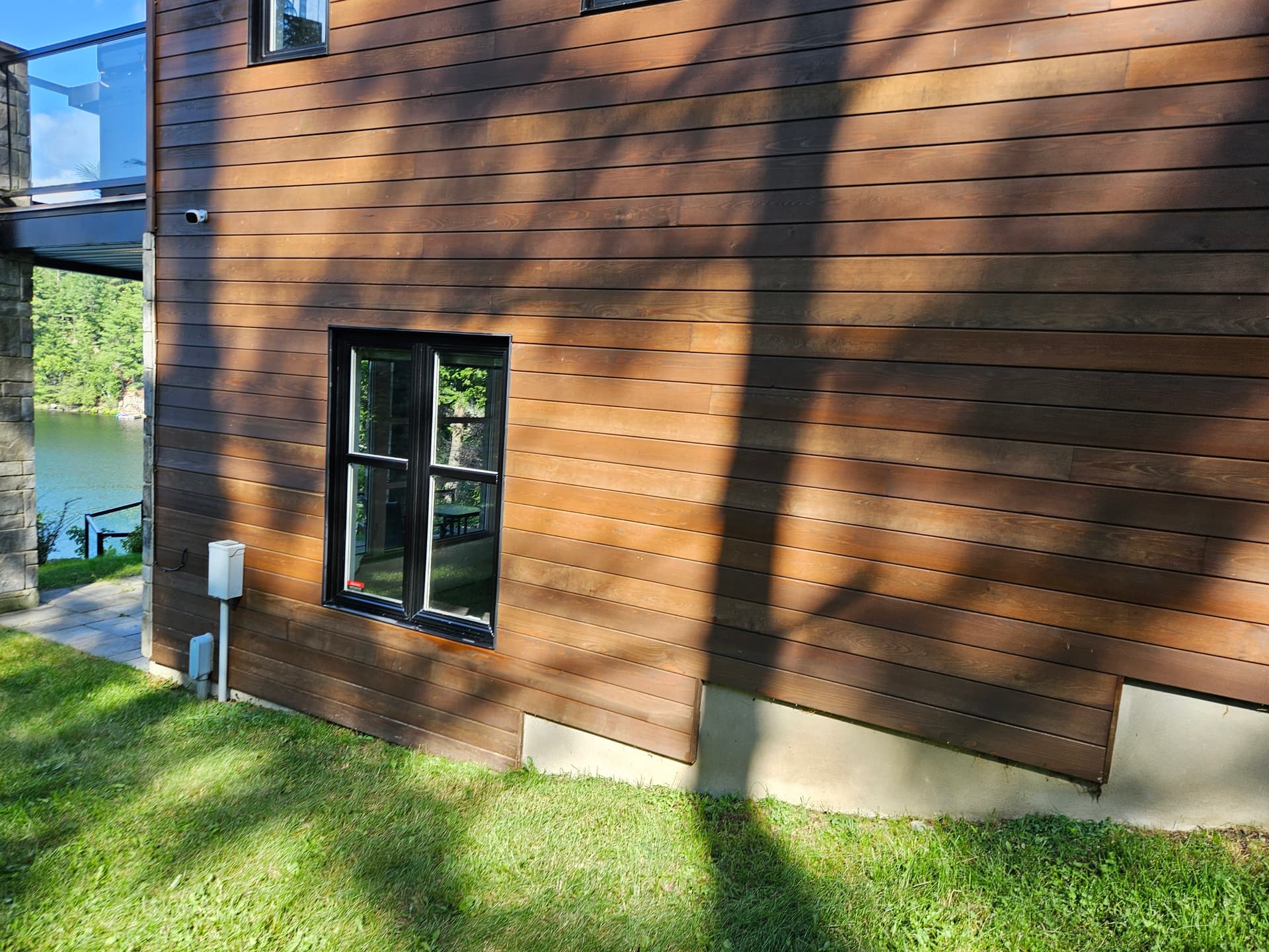

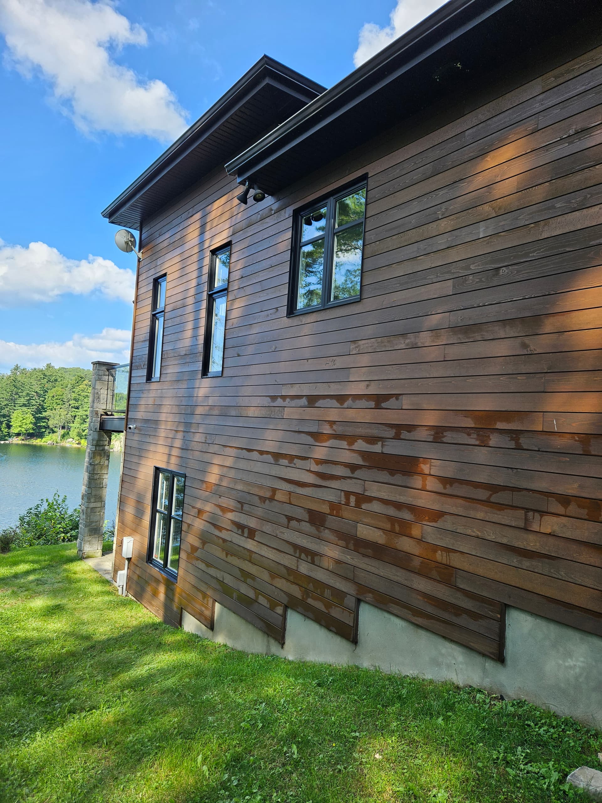

Stained wood though, tested hw mix in corner, looked fine when dry. Will prewet wood also.
Just a bit worried about water going in a crack in the wood like that time i had to call the firefighters…
