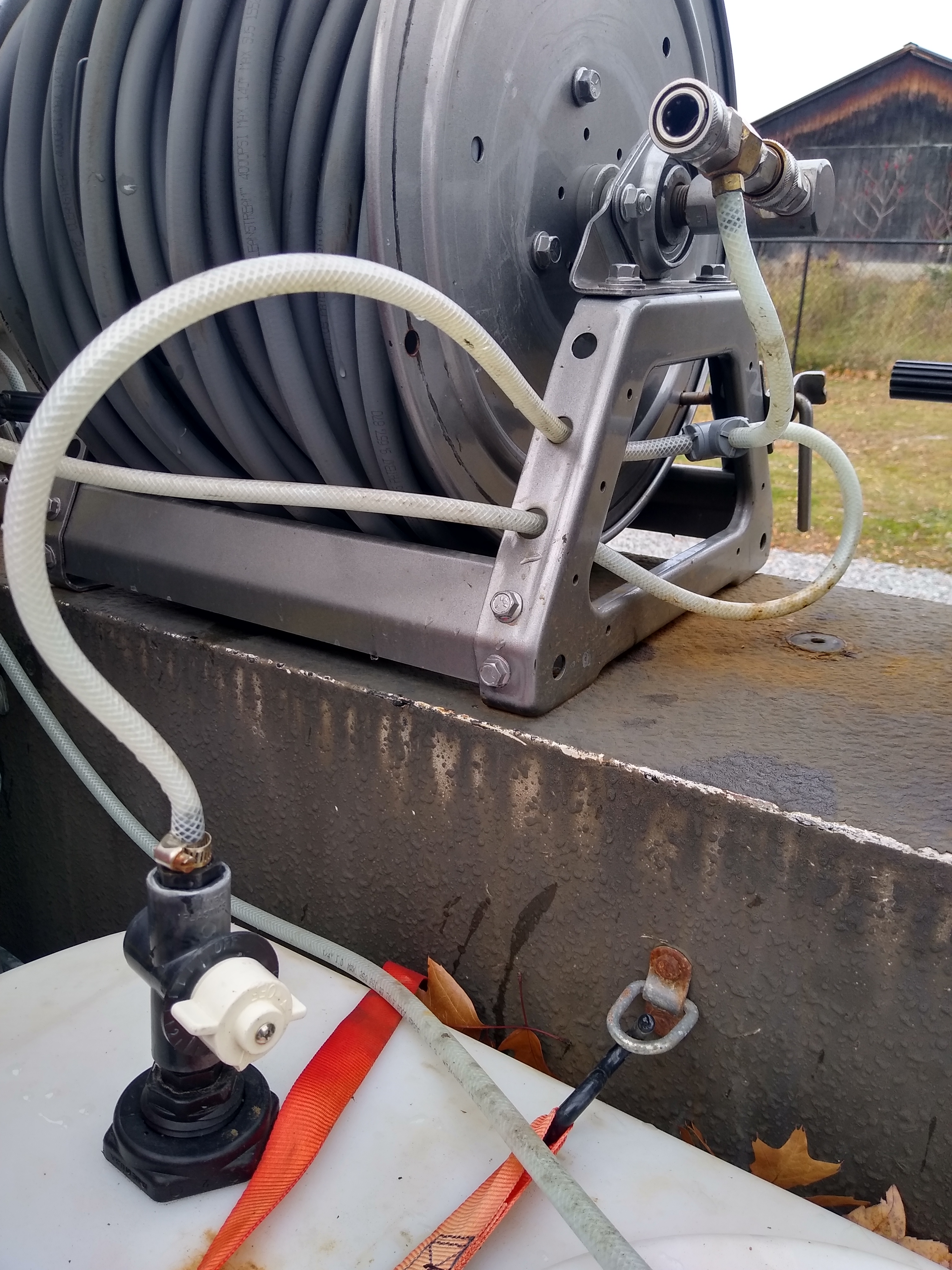

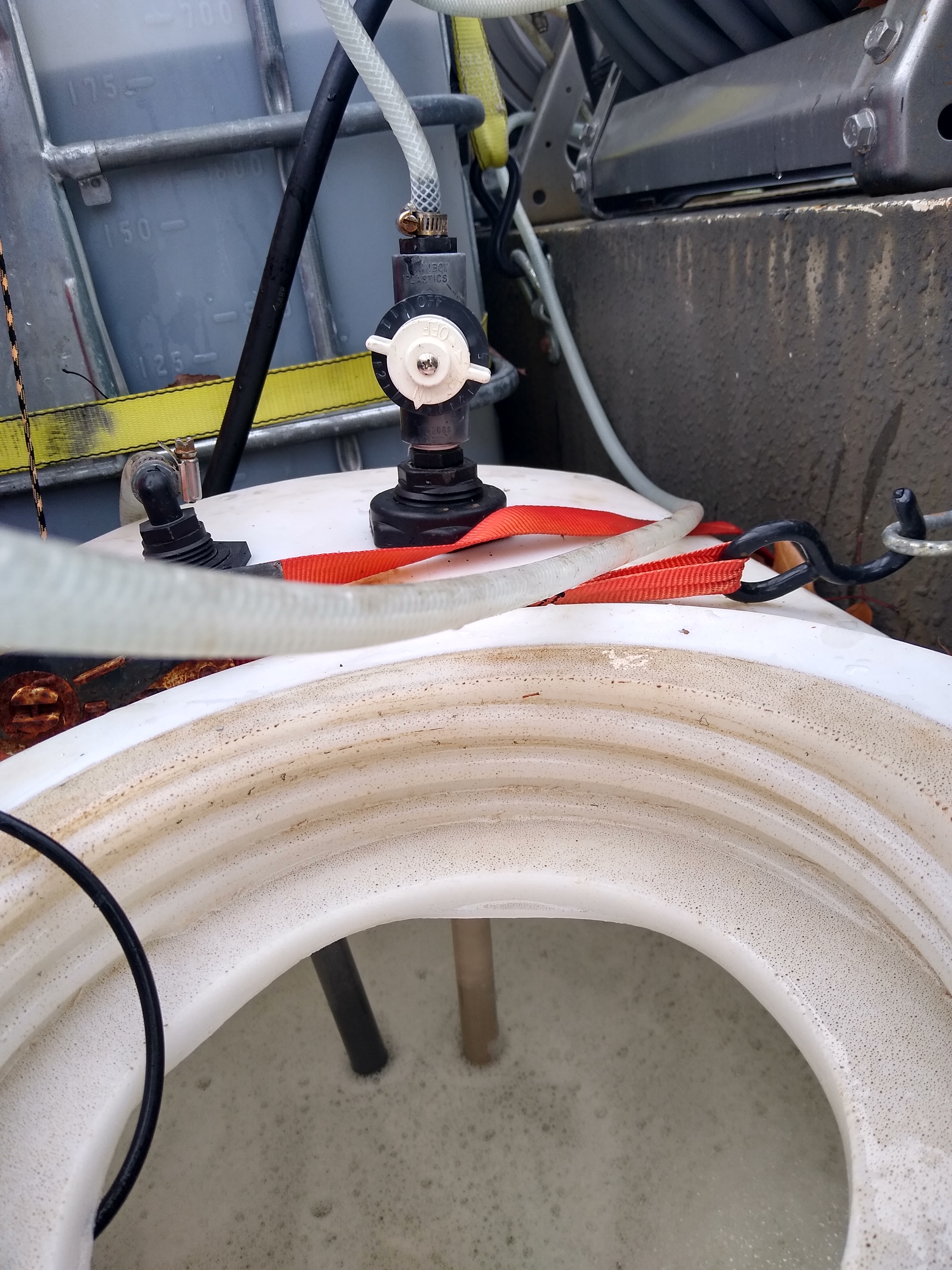

Can you post a pic of your metering valve for your DS? My 8 isn’t pulling enough soap for dirty houses and I’m tired of mixing buckets for each house. I’m thinking of installing a metering system.
Sure thing… Mixing valve on top of bulkhead for drop tube in sh tank, then from mixing valve to three-way valve to injector
Thanks. I was picturing something more complicated. I like that.

I think it depends on the injector on the draw. I like the idea of the metering valve on the drop stick.
Does your soap last in the sh tank for days/week? What soap do you use? How long does that metering valve last? I think I’m going to do the same thing. I don’t want 3 metering valves when one will work for me.
I use Elemenator and it has had no negative effects on the bleach. Last year I had a maybe 5-10 gallons left in my tank before winter, and used it to wash my house in the spring with no issues. I’m sure the strength was weaker from sitting, but it didn’t turn it brown or anything like that. I just finished my third year using the same metering valves. I have done no flushing or maintenance of them at all. Our season up here in Vermont is only 6 months though, so that three years is really only 18 months of use.
I know this is old but it sure helped me! The picture of the metering valve to the DS injector is ingenious. Obviously most will run the line from the SH metering valve to a remote DS controller then to the gun, right?
