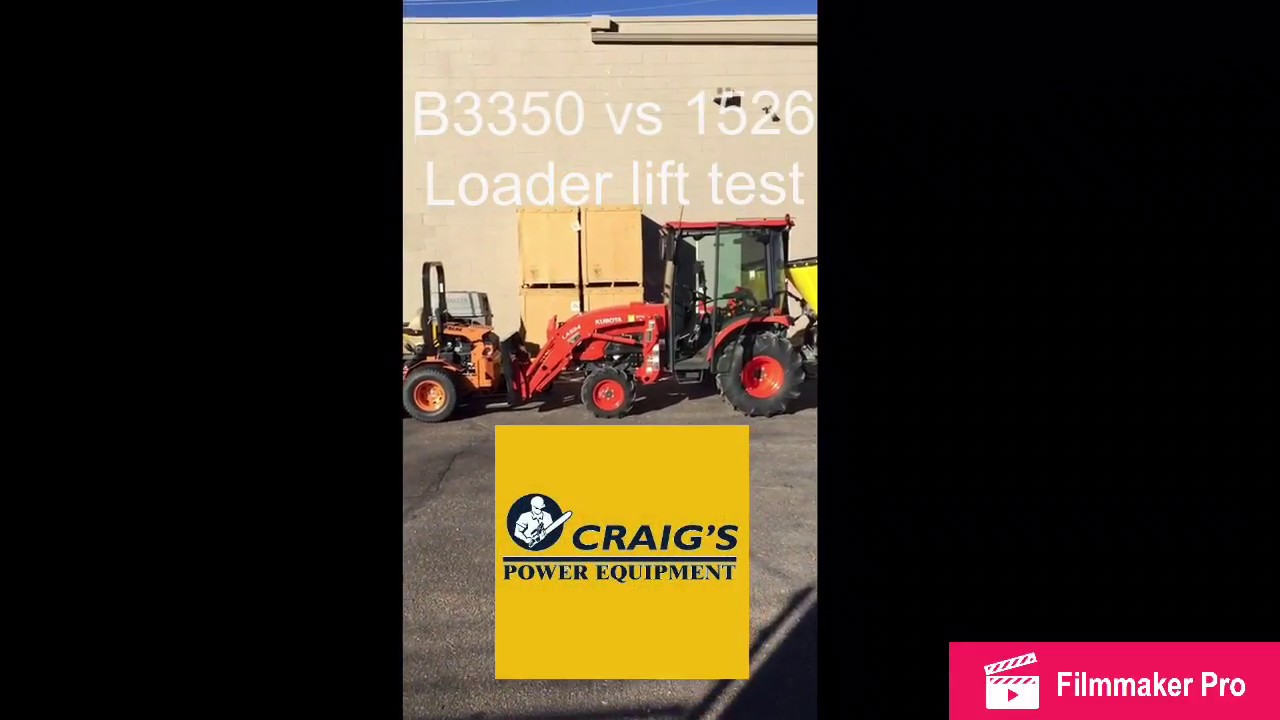

This shows the Mahindra 1526 (now known as the 1626)

That 1526 is impressive. I’ve used a Mahindra tractor in the past (no idea which one, didn’t pay attention to those things back then) and that thing was a beast. Pulled the brush hog no problem and could lift some pretty heavy stuff with the loader. I read that Mahindra sold out or something and that getting parts was harder than other brands but I honestly have no idea on that stuff.

It’s been about 3 years since I’ve been in the sales field, but at the time Mahindra was the largest tractor conglomerate in the world. In the USA, it was #3 behind Kubota and Deere, but sold more units world wide than the others for sure. Mahindra own many other brands, so I doubt they sold out. The 1500/1600 series is a former Mitsubishi Tractor painted red with modern upgrades. Mitsubishi tractors in one of the brands Mahindra bought out. That 26HP engine was our bread and butter in both the smaller and larger frame units for people with 10 acres or less.
